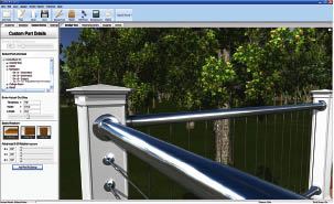

DeckTools was designed for deck builders and carpenters, not for the Einsteins of the world. It calculates the square footage of the deck and the length of the rail as you go. It’s simple to add stairs and rails or adjust the decking orientation — click in the Design Tool box and on the location on the design. Set deck and landing elevations by clicking the Details box and entering the height.
The program can also be set up to design decks the way you build them. For example, you can set the defaults to space columns along a beam depending on the size of the deck, determine joist size based on span and joist spacing, and find footing sizes based on the deck.
When a design is completed, it can be viewed in several ways. I can remove the decking layer with a mouse click and view just the structure, which I can tweak as needed. Clicking over the design displays the dimensions. I don’t have to draw different elevations — the program creates them from the initial drawing. The views can then be printed out: structural drawings for the permit application, working drawings for the crew, and detailed finish views for a homeowners’ association.
Pricing is quick and easy, though you have to regularly update your material-cost data. DeckTools can be set up to display your costs or your customer prices, using stick-by-stick or square-foot pricing.
All these features are great, but as far as I’m concerned, the key benefit of DeckTools is its value as a selling tool. I can show the customer plan and elevation views — and a realistic 3D image, which can be rotated, letting the customer see the deck design from every angle.
Additionally, the DeckTools “3D Materials Library” makes it possible to show decks rendered with a variety of products (see list below), giving the customer a sense of how various options would affect the look. I can even show several colors of selected decking and place deck furniture on the design to better demonstrate the scale and potential use for the customer.
