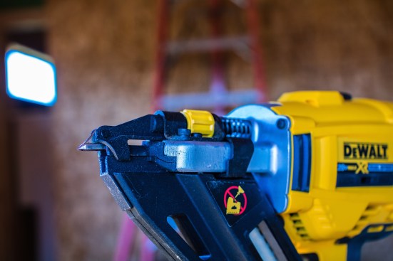

Features. This positive placement gun has the same features of any positive placement gun we have tested, plus a couple. Positive placement nailers use either the nail itself (like the Hitachi does) to find the hole in the hardware or a probe attached to the tip of the nosepiece (photo, left), which is what this DeWalt gun has (and Paslode, which brought to market the first positive placement gun).
I prefer the Hitachi design because I find it faster, but the probe works well too. The difference is most noticeable when it is a little dark or cramped and access to the hardware is limited. Then you are finding the hole by feel with the gun, and for me it is easier using the nail and not the probe. But the difference is really a matter of preference.

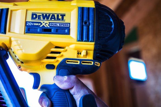

The firing mode on this gun can be set to sequential or rapid fire (photo, left). Rapid fire just keeps the flywheel spinning so you can pull the trigger and not have wait for the flywheel to get up to speed to shoot the nail. We kept the gun in this mode because we try and install as much hardware as we can to a beam while the beam is on sawhorses. I found, too, that when shooting on hurricane clips, I preferred to keep the gun in rapid cycle.

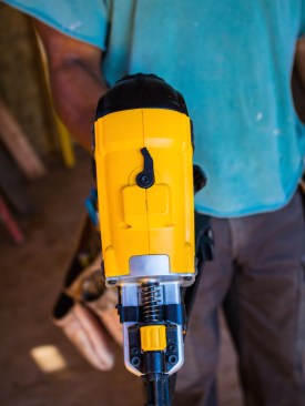

We found that the driver pin kept getting stuck when we were shooting HD galvanized 2 ½” nails. On top of the gun is a lever to reset the driver pin (photo, left), which makes getting out of a jam fairly quick. It seemed we had trouble with just that batch of nails. We also had one nail jam and get bent in the nosepiece, but that was easy to fix. DeWalt has an Allen wrench on the gun that made it easy to remove two screws and pop the magazine off. It is common for us to miss on thicker hardware and the nail to bend in the nosepiece. This has happened with every gun we’ve tested, but DeWalt makes it easy to quickly fix.

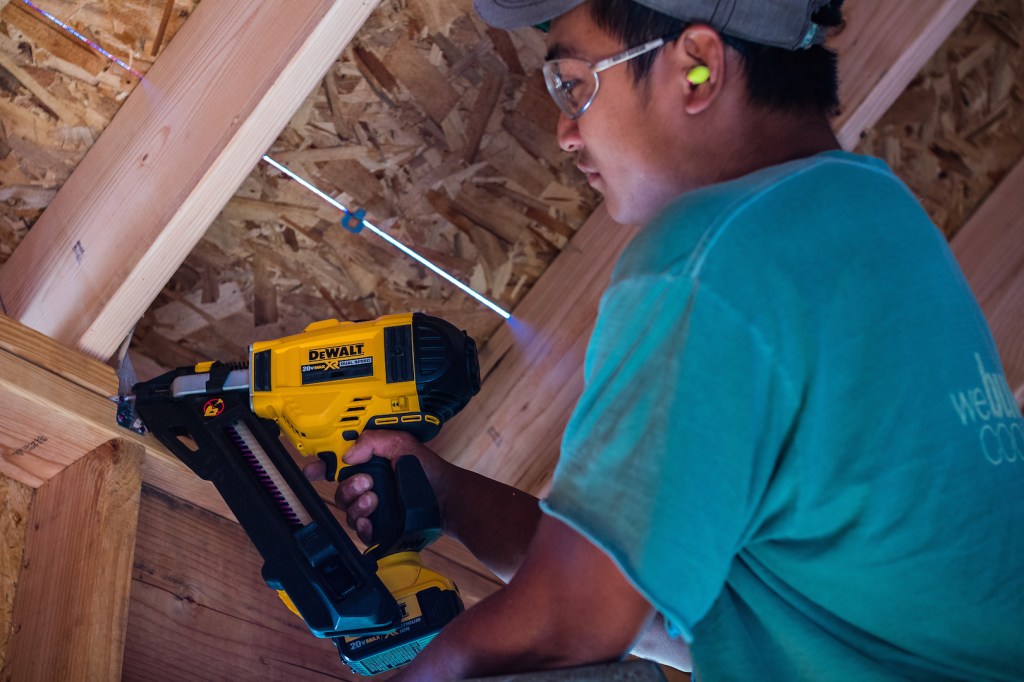

I found when shooting hurricane clips onto rafters that were 16” o.c. that, even with a ceiling joist nailed next to the rafter reducing the space, I could still fit the gun on an angle and was able to shoot off the hardware. We’ve learned to plan ahead and are usually able to leave room for guns to shoot hardware; and if not, we use a palm nailer.
