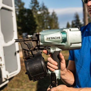

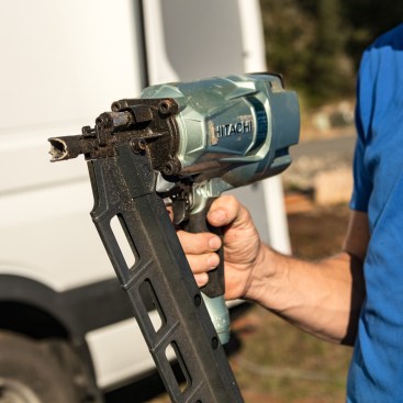

The nosepiece is made of hardened steel and is more aggressive than our old guns, which results in better toenailing in engineered wood like LSL. The nosepiece has an open design, too, making jams easier to clear. The coil nailer by design is easier to clear jams because you have complete access; there is no magazine that blocks access to jams.

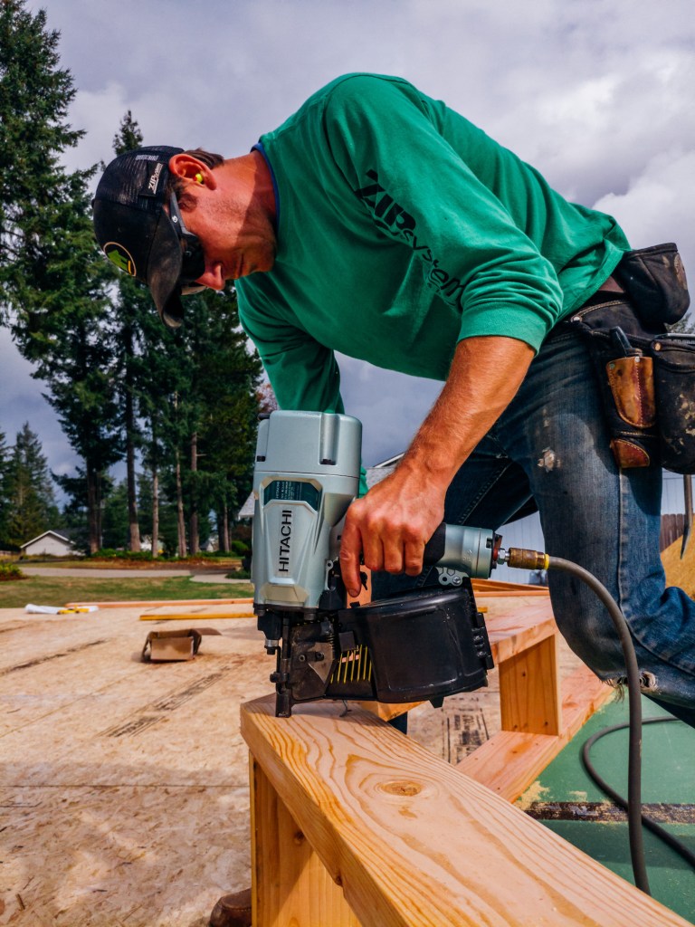

In Use First off, I will say that I prefer a coil nailer. Using both of these guns, I found that the coil framer is better balanced, because the nails are centered on the handle. The framing nailer feels off balance because the magazine length is so large. The coil of nails balances this out.
I’ve read that a lot of guys complain that a coil nailer is too heavy; it’s true that it is heavy, but the load capacity is more than twice that of a stick nailer. We’ve found the weight of a coil nailer not to be too big of a problem. To me, it beats carrying extra sticks of nails in my bags, so the capacity of a coil nailer offsets the weight issue for me.
