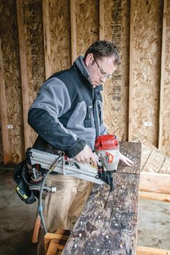

I run a framing crew in the Pacific Northwest, and in this part of the country we use full round-head (FRH) plastic-collated stick nails. These nails are collated at an angle of 21 to 22 degrees, and the guns that take them have longer magazines than the guns that drive paper- or wire-collated fasteners. I’ve been using this type of tool since high school, and the thing I like most about the newer models is how much lighter they are than the guns I learned on. Many of these guns have also been shortened top-to-bottom to fit more easily between tightly spaced framing members.
For this article, my crew and I tested the seven plastic-collation stick nailers that weigh less than 8 pounds (with an air fitting but no nails). We wanted to test the very lightest models, and that seemed like a reasonable cutoff. The paper-collated versions of all of these tools are listed in the spec chart on pages 18 and 19. Those models have different magazines than the guns we tested but are otherwise the same.
Our method of testing was simple: Take the tools to the job site and use them in the normal course of our framing work. Later on, we drove full clips of nails into lumber at varying speeds and counted the number of heads that were not set flush.

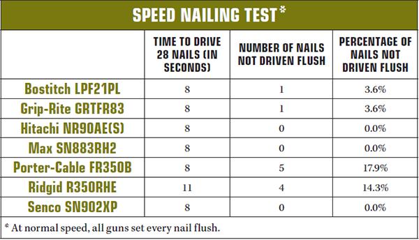

Here’s how the nailing tests were performed: With the compressor set to 115 psi, I put a 28-nail clip of 3-inch by .131-inch nails into each gun and then bounce-fired into a double layer of LVL until it was empty. For models that don’t let you fire the last few fasteners, I loaded enough to fire 28. I performed the test twice, waiting for the compressor to refill and stop running before starting with another gun.
In the first test I fired at the pace I’d normally shoot framing, and none of the guns left any nails proud. The guy I was working with pointed out that when we frame walls we normally shoot three nails through the plate and into the stud, take a step, and then shoot the next stud. Used that way, the guns have time to cycle and have little trouble driving fasteners flush. In the second test I fired as fast as the guns would go while another carpenter timed how long it took to empty the clip.
I wouldn’t make overly much about these results, because there are only a couple of times you nail this way in real-world framing. You do it when you gang LVLs together — and even then the guns have time to cycle because you drive three nails and then move 12 inches down the board for the next set. You might go faster nailing sheathing, but the fasteners will be smaller and take less power to drive. The five guns that left zero nails or one nail proud were at the top. The Porter-Cable and the Ridgid were at the bottom. I was not surprised by the Ridgid, as it felt slower when I used it to frame.

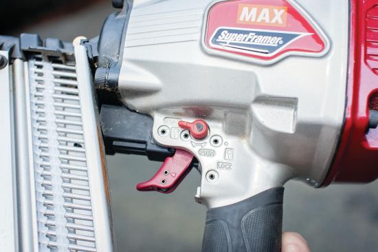

Firing modes. Like most framers, I use bump-fire 99% of the time. I only use sequential when there is no choice but to nail near where I’m holding something, or when I can’t afford for the pieces to move in the event of a double-fire. In that case, if the gun has a mode switch, I’ll change to sequential.

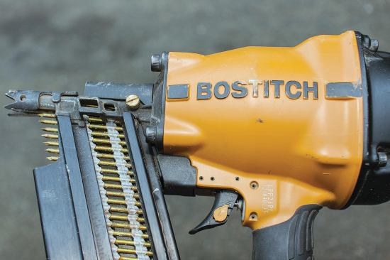

These guns come from the factory set to fire sequentially, but are easily switched over to bump-fire (contact-trip). All are equipped with a selectable trigger that allows you to change modes at will. It's slightly different with the Bostitch; the selector switch cannot be operated without first removing a pin. Once the pin is gone you can switch back and forth between firing modes.

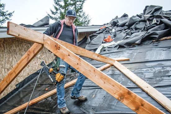

Rafter hook. I think every framing gun should come with a belt or rafter hook. The Hitachi and the Max are the only guns in the group that don’t have this feature. For the tools that do have them, some hooks are better than others. Senco’s hook is fixed to the right side of the gun, which is fine for me because I like to hang the gun from the left side of my pouch. Most of the guys I work with prefer to hang their gun to the right, so the Senco would be a problem for them. The hooks on the Grip-Rite, Porter-Cable, Ridgid, and Bostitch tools swivel to either side. Bostitch’s swivels a little too easily and sometimes gets turned around when hooked to my bags.
Magazine. The Grip-Rite can be loaded from the top or the rear. I don’t see an advantage in this, but it is kind of interesting. The only jams we’ve had with any of these guns were when the nails or collation were broken or damaged. Max and Bostitch have a magnet built into the nosepiece to keep the last nail straight so the tool won’t jam. I don’t know if this helps, because jamming was simply not a problem with any of these guns. About half of the guns have dry-fire lockout, which prevents them from being fired when the magazine is empty. This feature doesn’t matter to me and would have no effect on my purchasing decision.
Depth-of-drive. All of these guns have a tool-free depth-of-drive adjustment. The Max and the Hitachi have the adjustment in front of the trigger, and the rest of the guns have it on the nosepiece. I found the Max and the Hitachi the hardest to adjust, and they also seemed to get grime stuck in them the most. The Senco, Bostitch, Grip-Rite, and Ridgid guns have the adjustment on the nosepiece and are the most consistently easy to adjust. I can’t pick one as better; they all did a great job.
