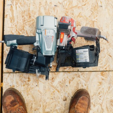

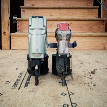

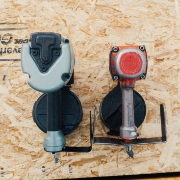

These photos illustrate contributing editor Tim Uhler's framing nailer setup. Several of the photos show the difference in size between a typical pneumatic coil framing nailer and the Max PowerLite HN90.

Benefits to a high-pressure system. The major benefit to a high-pressure system is the lighter weight of the guns. We have run coil nailers for 15 years and love them. We find that it is easier to clear jams, and there's less reloading time due to the higher capacity. The downside, of course, is that more nails means more weight. The high-pressure guns are smaller and lighter to begin with.
