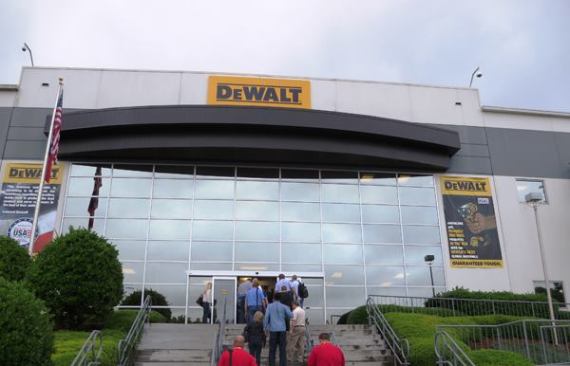

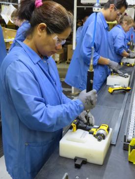

Last week I was among a group of journalists who toured the Charlotte, NC facility where DeWalt builds cordless power tools. The event was held to announce a group of new tools (more on them in an upcoming story) and to show tradesmen that the production of some tools has been brought back to this country.

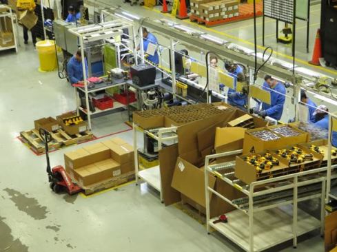

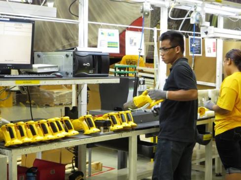

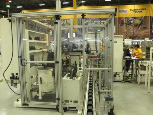

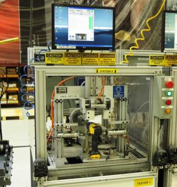

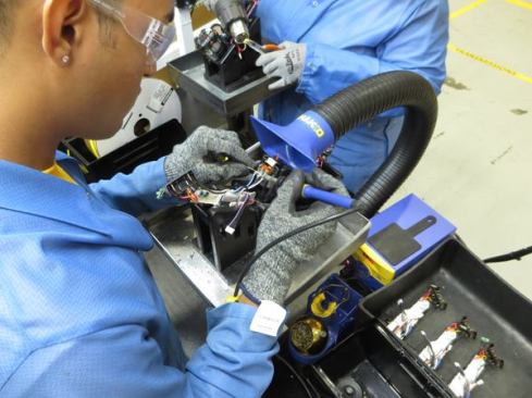

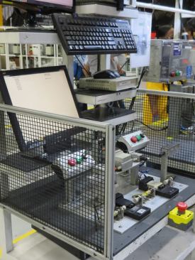

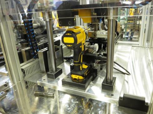

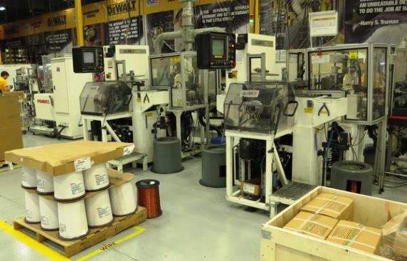

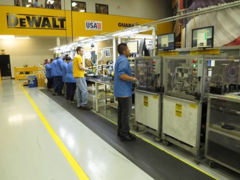

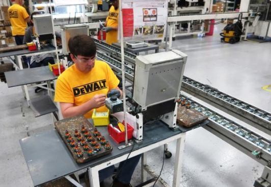

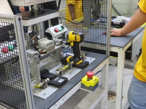

Several things stand out about the Charlotte assembly plant. This was my first trip to a facility where cordless power tools are made and it never occurred to me that after a lithium-ion tool is assembled its electronic memory must be programed. And I had no idea every tool produced in the plant would be subject to electronic and mechanical testing to verify it performs within spec. Finally, I was surprised to learn how many of the components that go into the tools made in the U.S. The brushed motors used in some of the tools are wound and assembled on site. Other parts come from SB&D plants in Cheraw, SC (plastic housings), Hampstead, MD (powdered metal gear housings), and New Britain, CT (machined parts). Of course some parts are imported and will likely continue to be—though sourcing varies by tool and may change over time.
