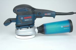

One of five models in our mixed category test of variable-speed rear-handle and right-angle 5-inch random orbit sanders, this tool is one of the three high-speed, fine-finishing models. And it’s among the newer generation of rear-handle sanders with a removable front handle. As the latest tool to the category, it boasts technological advancement that makes a marked difference in comfortable performance and makes this a real standout tool.

Excellent overall.
The profound lack of felt vibration is its most desirable trait, but this sander does everything right. Superb finishing, fast stock removal, and with all the best features too. Hands down the most enjoyable sander to use I’ve ever experienced due to its incredibly smooth operation.

The most notable feature of this sander is its highly effective suspension system which isolates the outer housing you grip from the vibrating inner workings of the tool. As shown here, foam isolation mounting pads glued between the housing and the motorized mechanism do the trick. As mechanically simple as this suspension system is, it makes you wonder why the manufacturer didn’t develop it many years ago.
Vibration
Excellent (very smooth)
Truly remarkable in this regard, this sander’s almost non-existent vibration is its main claim to fame. It earns this accolade through the use of an ingenious yet simple suspension system that consists of four small foam pads that isolate the housing from the mechanical parts inside.
