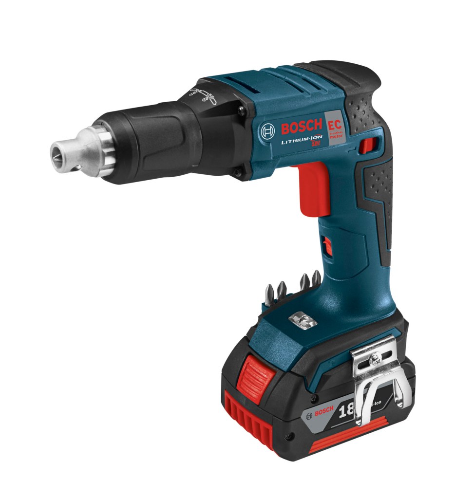

This is the official photo of the SG182 Drywall Screwdriver—which is scheduled to be released in the U.S. in September 2014. It's shown here with a 4.0 Ah FatPack battery.
Bosch recently announced the new SG182 cordless drywall screwdriver, an 18-volt cordless tool aimed at commercial contractors for drywall and metal stud work. It’s being promoted as as “the first cordless screw gun to deliver the performance of a corded model without the limitations of a cord.” The benefits of that should be obvious, complete freedom of movement with no cords to snag, drag, or be rolled over and destroyed.
According to its maker, the SG182 has three times the runtime of its current competitors and can do a full day’s work on a single charge—driving 3,500 screws when equipped with a 4.0 Ah battery. Compatible with all Bosch 18-volt lithium ion batteries, the tool will drive even more fasteners per chage with the company’s new 5.0 pack (BAT621).
The SG182 has a familiar form-factor and can be held the same way as a corded drywall gun—with the back of motor housing tucked between forefinger and thumb. It has the same nose piece as the company’s corded models, forward and reverse, and a trigger that can be locked in the on position. The tool can be used by itself with bulk fasteners or with an optional auto-feed attachment (MA55) and collated fasteners.
The cordless drywall screwdriver is scheduled to be released in September 2014. The autofeed attachment is already available with one of the brand’s corded guns.
