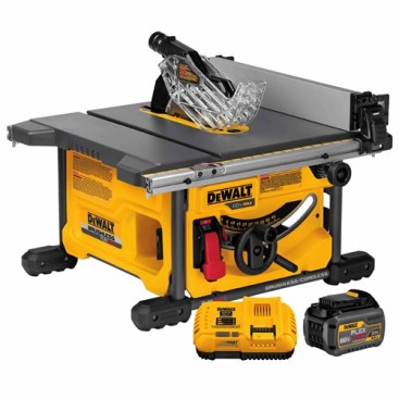

DeWalt made a big splash in 2016 when it announced its new FlexVolt battery platform. FlexVolt batteries offer 60V Max to run larger tools (like the Miter Saw my crew and I reviewed in March), and they also enable you to run them in 20V max tools as well. My crew and I liked the cordless miter saw enough that I decided to request for review the cordless table saw that runs on the same platform. It’s been a busy year for us and as we find ourselves spread out on more custom home builds and remodels, I find that I’m jumping around more and more as well. So I wanted to see what a cordless table saw could offer me by way of efficiency and convenience. I have used Dewalt’s DW745, which is a 10-inch corded compact portable table saw. I’ve found it to be a great tool, so using a cordless version had a lot of promise in my mind.
A Smaller Blade Diameter
As a start, I should point out that the cordless FlexVolt table saw runs an 8 1/4-inch blade. It’s a departure from what we’re used to seeing in terms of a table-saw blade diameter (10 inches), but the 8 1/4-inch blade offers a max cutting depth of 2 1/2 inches, which seems to suffice for a cordless saw. It told me off the bat that the tool’s use was meant for certain, limited tasks – and that it’s not a saw that I want for larger timber, which we cut all the time. That was fine for me because when we’re cutting larger timber (like 6-by Douglas fir), we have a contractor’s saw or heavy-duty jobsite saw set up. I was looking for something super-portable to rip trim or framing lumber without having to do any set up.

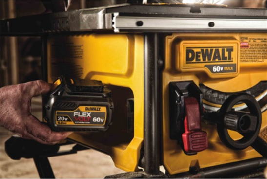

While it comes with one battery and a fast charger (40 to 50 minutes of recharge time), I have two more back-up batteries from the miter saw kit, so I never found myself wanting for more juice. If you do buy this saw and need to run it for a full day at a time, I would suggest having one or two extra batteries depending upon the kind of work you do. Keep in mind that harder, denser woods run the battery down faster than softer woods. Is it powerful enough for PT? I ripped some pressure-treated 2×6 down for threshold. The saw had plenty of power, but it sucked the battery life down much more quickly than regular framing lumber.

Price: $500 for the kit (DCS7485T1 comes with (1) 60V MAX 6Ah Flexvolt battery and fast charger)
