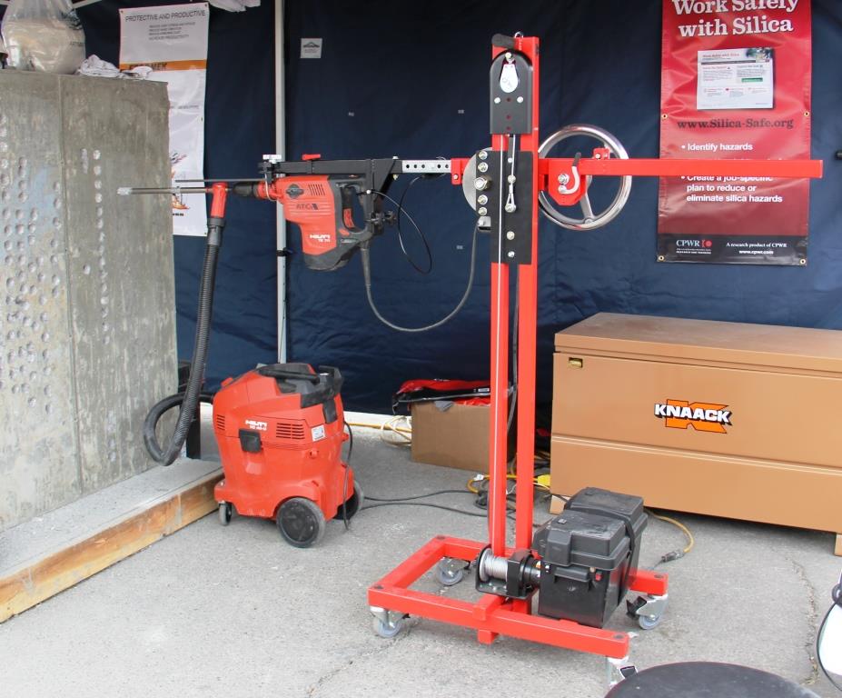

This rig holds one or more rotary hammers and is designed to boost productivity while reducing exposure to muscle strain, vibration, and silica dust.

The Drill Boss is the commercial version of a device developed by researchers studying ergonomics at the University of California in Berkeley. It’s a rig that holds one or more rotary hammers, and is designed to boost productivity while reducing the operator’s exposure to muscle strain, vibration, and silica dust. Instead of hand-holding a rock drill or rotary hammer, the operator stands off to the side and turns a crank on the Drill Boss that advances the tool into the work (see video below). Strain and vibration are absorbed by the rig; dust is handled by the dust collecting vacuum and shroud (or hollow drill bit) of your choice. The purchaser supplies the rotary hammer, which need not be a particular brand; any number of models can be bolted into the rig. Holes can be drilled horizontally, vertically, and at almost any angle in between.
Is there a Drill Boss in your future? Probably not, unless your company drills hundreds of holes per day or drills concrete on a regular basis. And there are companies that do that; most are involved with large commercial construction projects—which is where the device underwent testing. With a price tag of $4,500, the Drill Boss is beyond the means of the average contractor. But large construction companies may buy them and one can hope that some of the rental yards will too.
