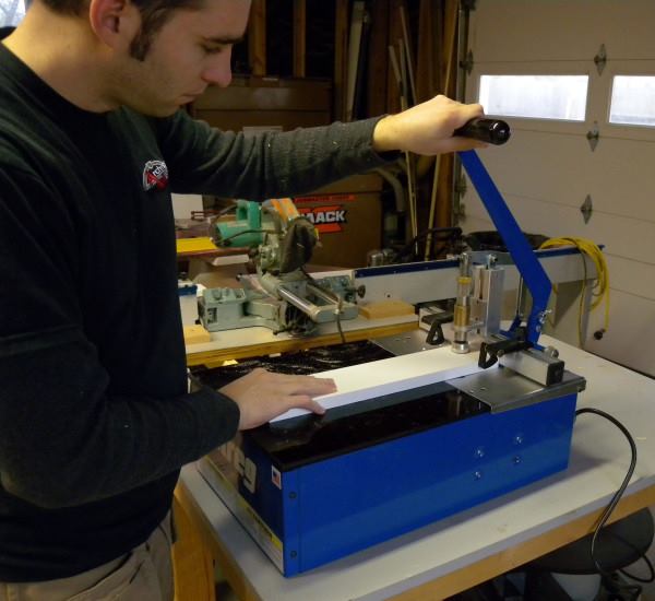

A few years back we upgraded to a Foreman model, a stationary tool that makes the same holes a jig does, only faster. The model we have (DB110) is about to be discontinued but similar machines will remain available, the pneumatic version (DB55) of the tool we have now and a new less expensive electric model (DB210) that is supposed to come out late this summer.
With the Foreman, there’s no need to handle a drill or clamp the jig to the work piece; you just butt the stock to the fence and pull the lever. As the lever comes forward it activates the motor, clamps the work against the table, and plunges the drill bit into the bottom of the piece. When the motor hits the built-in depth stop, you push the lever back and repeat the process for the next hole. This takes a second or two per hole — a fraction of the time it takes with a jig. For us, the labor we save justified the $800 cost of the machine.
The fence is equipped with adjustable stops that register the hole location from the edge of the material and can be rolled out of the way to make holes farther in, as is necessary with longer edges. Aside from speed and ease of use, one of the advantages of this machine is that it contains everything you need to drill pocket holes and is ready to go the moment you plug it in. Jigs require more setup, and in the rush to get to the job site it’s easy to leave a necessary part behind.
The Foreman’s motor is located inside the base and can be accessed for maintenance by lifting off the front part of the table. Maintenance requirements include lubricating the slides, adjusting the depth stop, and cleaning or replacing the bit.
On our jobs, we put the Foreman on a bench near our table saw and miter saw so that it’s ready whenever we need it. We use it on just about any butt joint where the back of the piece will not be visible: mantel pieces, face frames, and especially wainscot paneling. We might also use it to end-join short pieces of baseboard, crown, and other running trim.
