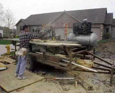

Our current trailer has a carriage made from 2-inch square steel tubing. A metal fabricator built the carriage and we attached the other parts ourselves. The tubing is welded together and connected to an axle and wheels that came from a local trailer and truck supply house. The frame was left unpainted because the paint would chip off anyway and the tubing is heavy enough that it won’t rust through. We built this trailer so the hitch can be removed by pulling a pin. The tires come off in a similar manner. This allows us to leave the trailer on site without having to worry that someone will steal it. The trailer has tail lights, turn signals, and a license plate. It’s registered as a 1/2-ton home-built trailer.
Equipment and Storage Boxes
On the right side of the trailer there’s a 14-inch radial arm saw. The saw is bolted to the frame, so at night we have to cover it up with a tarp. The cut table and fence are made from two-by lumber and are also bolted to the frame. We’re building another trailer right now and its cut table will be made from Trex decking.
The left side of the trailer contains a couple of job boxes and a large air compressor. The boxes are bolted to the frame and used to store air hoses, electrical cords, and supplies such as nails, joist hangers, and construction adhesive. The air compressor has a two-stage pump, 5-hp motor, and a 50-gallon tank. I don’t know how many framing guns it will run, but we’ve run 10 guns at the same time and not had problems. It’s unusual for us to run this many guns, so we could probably get by with a 30-gallon compressor.
Radial arm saw. We use the radial arm saw to gang-cut framing and siding. We also use it to rip framing, sheathing, and exterior trim. We bought the saw used from a local company that sells new and used equipment but specializes in rebuilding radial arm saws (Wolfe Machinery Company; Johnston, Iowa; 800/345-6659; www.wolfemachinery.com). I’ve considered using a sliding miter saw because it’s smaller and cheaper than what we have. However, a slide miter saw is not as powerful or durable as a big radial arm machine. In addition, a miter saw can’t rip, so we’d have to start bringing a table saw, which we don’t currently do.
The trailer is equipped with three adjustable legs. They fold down from the frame and are used to level the work surface. The trailer should be positioned so the front of the work table is slightly higher than the back. That way there is no tendency for the saw carriage to roll forward by itself. Our saw is equipped with an OSHA required return device that automatically pulls the carriage to the rear position.
We drop the trailer close to the front of the building but far enough back that it doesn’t obstruct work traffic. Most of the builders around here have all-terrain fork lifts, which we use to bring material to the saw and from there to the building.
