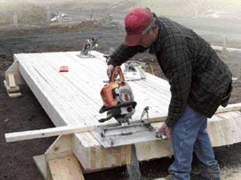

Production Cutting
The idea behind this method is to run the saw through all the rafters in a single pass. We do the head cuts first, the tail cuts second, and the birdsmouths third. Circular saws do not have the depth of cut to gang-cut the heads and tails. Instead, we use an adjustable table attachment on a chainsaw to make the long straight cuts.
We always make the head cuts first. That way we can recut them if the angle is a little bit off. A 2×4 nailed to the top of the rafters makes a good fence for the saw. We usually cut the tails before doing the seat and heel cuts because there’s nowhere to nail the fence if the birdsmouths are already made.
We use a slow, smooth cutting action and let the saw do the work. The table should be held tight to the top of the rafters. If one side of the table comes off the work, the pitch will be wrong and there will be gaps where the rafter hits the ridge. A good coating of silicone spray on all chains, blades, and tables reduces friction and keeps blades sharper longer.
