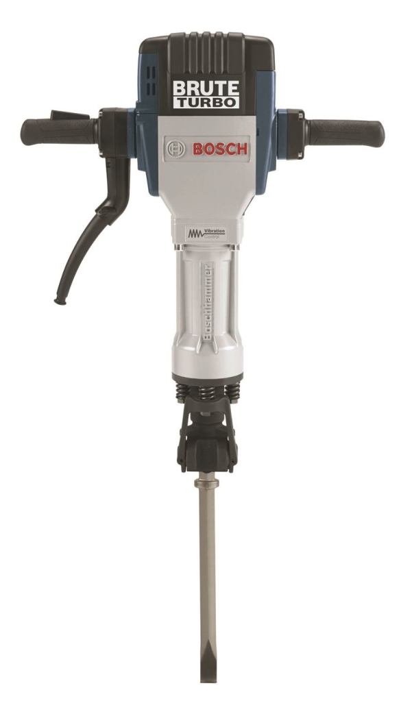

One of the biggest names in electric breakers is the venerable Bosch Brute. But an even bigger one is the Bosch Brute Turbo BH2770VCD. Even after the reboot of the original Brute made it 50% stronger than before, Bosch decided to make a model that went all the way to “11” with the Turbo. The 63-pound tool hammers out 43 foot-pounds of impact energy at up to 1,000 blows per minute. The brand’s Active Vibration Control and extended air cushion in the hammer mechanism provide the tool with an 8 m/s2 vibration rating. The breaker comes standard with a hand truck, complete with two points and two chisels onboard in dedicated slots.
