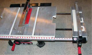

Despite a modest table (28 by 18 inches), the saw can make rips of up to 24 1/2 inches wide when the extension wing is used. The wing is supported by steel rods held in place with two thumbscrews. For wide rips, the author always double-checks that the fence is parallel to the blade.

The table is 28 inches by 18 inches; a 5 1/2-inch movable extension on the right side gives it a surprising 24 1/2-inch rip capacity. The saw also has a small outfeed extension on the back that’s useful for smaller stock.
The rip fence is the usual clamp-down style. The attached scale is pretty accurate for smaller rips, but the extension isn’t always parallel to the blade during wider cuts, so I always double-check the fence with a tape measure.

The saw does not come with a zero-clearance insert, nor can you make one, since the throat plate covers only the right side of the blade. A big gap to the left of the blade is not covered by anything, and the plate itself also has a large gap, so you need to be extra careful with thin stock.

Because of gaps on both sides of the blade, cutting narrow stock is difficult — and the saw’s cast-aluminum top makes it impossible to use a shop-made zero-clearance insert
