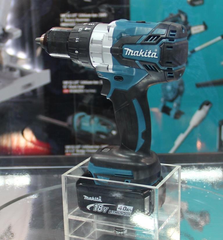

This prototype of the XPH07 was photographed at the STAFDA show in November 2013. If the motor housing looks bigger around than normal—it's because it is. This drill/driver has a large motor.
This is the opposite side of the prototype. Note the 4.0 Ah battery. It wasn't out when the photo was shot but will soon be available for purchase.
This is a photo of the DHP481, which is out in Japan, Australia, and some other parts of the world. The U.S. version of the tool will be called the XPH07.
Makita This is a photo of the DHP481, which is out in Japan, Australia, and some other parts of the world. The U.S. version of the tool will be called the XPH07.
Last fall at the STAFDA show I saw a prototype of the XPH07, a new Makita cordless hammer drill. It was inside a plastic case and I was unable to touch or try it out but was told it would have more torque, speed, and runtime than any tool of its kind. The drill has yet to be announced but ads have been circulating that say it produces 1,090 inch-pounds of torque, 365 inch-pounds more than its closest competitor, the Milwaukee FUEL model 2603 (725 inch-pounds). That’s a huge disparity.

The XPH07 has a brushless motor and at 8-1/16 inches long, is 3/4 of an inch shorter than the predecessor model. Features include a single sleeve 1/2-inch metal chuck, dual LED headlights, belt clip, side handle, and something Makita drills have not had before—a built-in three-bar battery gauge. The side handle is exceptionally long, which makes sense given the tool's high torque rating.
At 5.9 pounds with a full-size battery the hammer drill is heavy for a tool of its kind. By way of comparison, a similarly equipped Milwaukee M18 Fuel drill/driver weighs 5.0 pounds and a DeWalt (DCD980) drill/drivers weigh 5.2 pounds. The new Makita hammer drill is also quite fast, with no-load speeds of 0-550 and 0-2,100 rpm. The M18 fuel tops out at 1,850 rpm and the DeWalt at 2,000 rpm.
