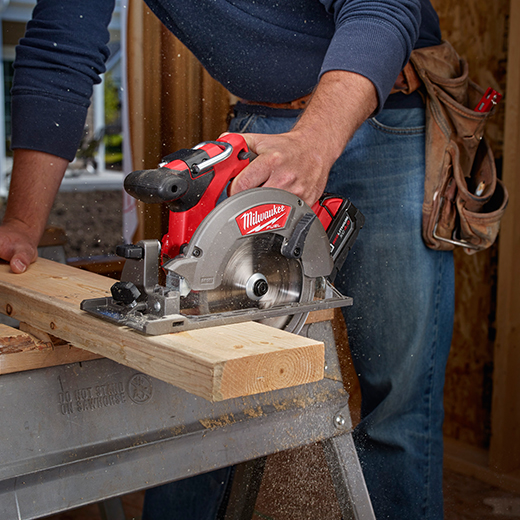

Like most other 6 1/2-inch blade cordless saws, the 2730 is a blade-left model. I appreciate the tool’s premium features: a quick motor brake, generous rubber grip surfaces, a sturdy folding hang hook, bright LED headlight, effective dust blower, and an accurate bevel quadrant marked in 1-degree increments up to 50 degrees. Markings on both the bevel quadrant and the front of the shoe are concisely engraved in stainless steel plates for permanence. The 90-degree bevel setting is adjustable, however, one feature conspicuously absent is a stop at 45 degrees.
In use, the cutline marker is centered exactly on the blade, though wider than the blade kerf, and the line of sight is pretty wide open during right-handed use. Unfortunately, the guard hung up whenever I made shave cuts on the right side of material if the blade was set much deeper than the material thickness. The guard worked fine if I set the depth-of-cut just deep enough to pass through the piece—but it was an extra step.
The magnesium shoe is stiff and sturdy, but narrow in width, making it easy to tilt the saw slightly and cause the back edge of the shoe to hang up on the corner of a board being cut. Again, this is largely attributable to the blade-left design. If the shoe was wider to the left it would be easier to keep flat during a cut.
In spite of these complaints about the saw’s format, I was impressed by its performance; it proved to be a strong and fast cutter in all materials. It didn’t feel like a compromise tool; it felt like a “real” circ saw.
