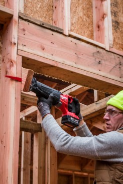

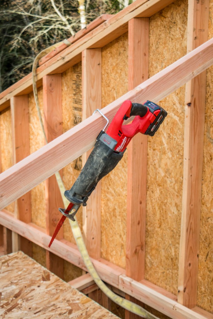

Features. This recip saw shipped with 2 M18 XC5.0-Ah batteries and a charger (and box to store the kit). This tool also features One-Key technology. An LED light illuminates the blade and cutting area; the blade clamp is tool free (called QUICK-LOK Universal); and this tool has a nice large hook. It also has a brake on the blade. The adjustable shoe is a nice addition to sort of “set the depth.” I use it only occasionally, but it is nice when I need it.
This recip has Milwaukee’s Powerstate Brushless Motor, which, according to Milwaukee, means more torque, longer motor life, and longer run time.

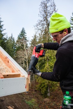

This recip is a step up from the first M18 Fuel and is a better recip than any corded model I’ve tried. I find that this tool cuts very fast, but I have a lot of control over the cutting. We recently had a customer add five windows after we’d finished sheathing 2×6 walls. We cut all five openings in less than 30 minutes total. The cuts were so clean that if you didn’t know it was a remodel situation, you couldn’t tell.

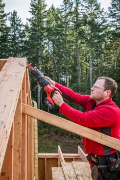

It has all the power I need as a framer/remodeler but with the added convenience of not having a cord to drag around, and it has a hook to hang it off the ladder when doing work up high. Another thing I like about this tool is that it has low vibration, which for me means less fatigue.

The real beauty, though, of this app with this tool is that I can change cutting speed, start speed (for instance, soft start), start duration, and cutting brake. Then I can save the settings and assign them to 1-4 on the tool as profiles. For common materials/cutting, I can save the profile in the app and just hit the corresponding button on the tool. Even the work light duration can be set. I use the slow-start feature when cutting threaded rod, which allows me to not damage the threading. A separate setting allows me to cut wood fast.
