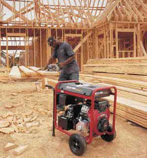

If your generator will be used all the time, spring for a wheel kit. A wheel kit not only makes moving the generator from the truck and around the site easier, it also makes maintenance easier. By getting the oil plug off the ground, it facilitates access to it and the air filter.
Wheels. You’ll find three types of wheels out there: solid rubber, pneumatic, and semi-pneumatic. Solid rubber wheels like you’ll find on Honda’s machines are typically about 2 inches wide and roll well on hard, dry surfaces. They’re a little trickier in ankle-deep mud. Pneumatic tires (about 4 inches wide), like the big 12-inchers you’ll find on Generac wheel kits or the smaller tires on Makita and Robin units, roll great in most terrain –especially mud — because they’re bigger, softer, and wider than the solid wheels. The downside is that they can pop, leaving you with one flat tire and 175 pounds of generator to get in the truck. The semi-pneumatic tires that are now available on some DeWalt and Porter-Cable models are made from thick rubber with an air pocket inside for cushioning. They’re not as easy rolling as pneumatic tires, but they’re big and wide enough to ride over soft ground and they won’t pop if you run over a roofing nail.
A wheel kit makes everything from mobility to maintenance easier. Look at the tire choices to see what’s right for you: pneumatic, semi-pneumatic, or solid.
