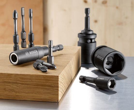

Bosch's pricey new Impact Control bits with  micro diamond coating for improved grip and longer life are available now in  Europe. The release date for the North American market is unknown.

As for new products, oscillating multi-tool (OMT) blades and related attachments represent a growing market for the brand, while the most interesting new accessory has to be the diamond-coated impact driver bits sold exclusively in Europe.
