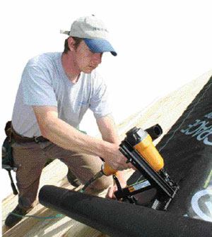

Bostitch SB150SLBC-1
Bostitch’s cap gun holds 100 1-inch proprietary caps and 160 staples. Since the proprietary caps are threaded onto a plastic leader — rather than coiled — you don’t have to worry about rewinding misshapen or dropped coils. However, this design means that the Bostitch requires more frequent loading than the Hitachi and Spotnails, which have larger, circular magazines.
Bostitch’s caps come in stacks of 100. They’re dropped in the top of the magazine and then the plastic string that collates them is removed, also from the top of the magazine.
The gun secures the caps with standard 5/16-inch-crown 18-gauge staples in sizes from 3/4 inch to 1 1/2 inches. Staples load as they would on a conventional pneumatic stapler: Once the pusher is pulled back and locked in the loading position, they can be dropped onto the magazine rail. We easily found 5,000-count boxes of staples ($16) at our local suppliers; a couple of stores also stocked the caps, which come in packages of 1,000 ($22). In our experience, it takes 1,000 caps to fasten about 1,800 square feet of roofing or housewrap.
With its front-mounted magazine, the gun looks as though it might be a little nose-heavy, but it’s not. The lightweight aluminum housing makes it comfortable to use. Because the contact element is mounted on the side, the user is forced to keep the gun square to the roof, which practically guarantees that fasteners will be positioned flat for maximum hold.
Other features include a quick-release nose for clearing jams and an adjustable exhaust. The gun’s depth adjustment is located just below the trigger.
With a plastic case — plus starter packs of staples and caps — the Bostitch sells for around $230.
