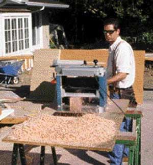

These days, there are many portable planers to choose from, which is good if you do the kind of custom work or repair jobs that require nonstandard material. For this article, I tested seven portable planers that a carpenter might encounter when shopping for tools. There are other portable machines on the market, but most of them are designed for hobbyists.

If I were in the market for a planer, I would probably buy the Makita or the Delta. I would also consider either one of the DeWalts. The other planers are not bad, but they’re not up to the level of the machines listed above.
This planer produces a good smooth cut with very little snipe. It has an exhaust blower and comes with a bonnet that allows you to feed chips directly into a trash can. On the downside, this machine is bulky, heavy, and produces a high-pitched whine at idle. The hard plastic grip inserts make it uncomfortable to lift, and the preset thickness stops are a hair off. It has a lot of bells and whistles but nothing useful like an indexing ring or adjustable thickness stop.
This is one of my favorite planers. It produces an excellent cut with no discernible mill marks or snipe. When you turn it on it feels and sounds solid and well made. With a new set of blades, it will put a smooth, glassy finish on maple. This machine has two feed rates, and the slow one would come in handy for lumber with irregular grain. I’m not a big fan of thickness scales, but Delta’s is nice because it’s high enough to read without bending way over. The zero-out indicator ring under the crank makes it easy to determine just how much stock you’re about to remove. I also appreciate the smooth lifting points high and low on the machine. What I don’t like about this planer is that it’s somewhat bulky and not particularly light. I’d prefer it if this machine had an automatic head lock.
The DW734 is a simple, well-made machine that produces clean cuts with no discernible mill marks or snipe. This planer is relatively compact and in the middle of the pack in terms of weight. It has an indicator dial under the crank and comes with an exhaust hood that will fit a 4-inch duct or a large shop vac hose. On the downside, it has a manual head lock, the top-mounted crank does not fold away for transport, and the slide-out handles are not very comfortable to grip.
This is an unusual-looking machine. I wouldn’t mind having it in a small shop, but at 92 pounds, it’s kind of heavy to haul back and forth to the job. It produces an excellent cut with no mill mark and little or no snipe. The upper handles are extremely comfortable, as are the ones lower down on the base. The DW735 has a low center of gravity, and the table is big enough that there is no need for extensions. There’s a large, comfortable hand crank on the right and a dial that controls accurate preset thickness stops on the left. The case is almost entirely plastic, but it seems like tougher stuff than the plastic that’s on the sides of the other machines. Despite two cutting speeds and a high number of cuts per inch, the DW735 does not produce an appreciably better finish than the other machines. The coolest thing about this planer is the system for exhausting chips. A fan downstream from the head sucks the chips out of the machine and ejects them at a high rate of speed. An optional $60 chip collection bonnet will allow you to feed chips directly into a trash barrel without the need for a vacuum. The main problem with the DW735 is that it’s heavy. I would also be concerned about what would happen to the fan (which is plastic) if a knot or hunk of wood broke off and got sucked through it.
The Jet planer looks like it came out of the same factory as the Craftsman; there are a lot of common parts. It cut cleanly with little snipe at the outfeed but usually some at the infeed side. This machine does have two speeds, but the grips are uncomfortable, and it does not seem particularly well made. For example, the lifting mechanism contains plastic pinion gears, while the other planers contain metal gears and sprockets.
This planer is my personal favorite. Compared to the other models, it’s exceptionally small and light. It does have an inch less cutting capacity, but with 12-inch blades, it will handle 99% of the planing tasks most carpenters will ever do. If you only look at the specs, you might expect the 2012NB to produce a lower quality of finish than the machines that make more cuts per inch. This is simply not true. This planer produces a smooth finish with no discernible mill marks. However, it will produce a small amount of snipe if you’re not careful about supporting the ends of boards. The 2012NB does not have a lot of bells and whistles. It’s just a simple, well-made machine. It has a rudimentary depth-of-cut gauge and no preset thickness stops. This doesn’t matter to me, since I don’t use those features anyway. But it does have an adjustable stop rod that allows you to make repeat cuts. My only complaints are that the dust hood is $35 extra and that a turn of the crank changes the height more than 1/16 inch.
This machine cuts smoothly but produces noticeable snipe at both ends. It’s not particularly light or compact, and there was chip bruising on softwood on all but the lightest cuts. The manufacturer does throw in extras such as a spare set of blades and a metal stand. However, a planer is not very portable if it’s bolted to a set of legs.
