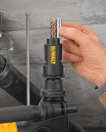

DeWalt Adjustable Depth Setter and Dust Collector
DeWalt announced these attachments early this year but I did not want to write about them until I saw them in person. The first item is the DWA5537DS Adjustable Depth Setter, which fits onto the end of a rotary hammer and can be set to stop the bit at a preset depth. It works with DEWALT's 3/8-inch, 1/2-inch and 5/8-inch SDS Plus drill bits.
The most likely use for the depth setter is drilling holes in concrete for drop in anchors. This type of work is typically done overhead, which is why DeWalt developed the DWA500DC Dust Collection System – a cone-shaped device that fits over the depth setter. There is no vacuum attachment; it merely catches the dust as it falls from the hole.
The depth setter sells for about $40 and the dust collector for about $13.
My take: The depth setter is simple to use and is a far better way to gauge depth than putting tape on the bit. The dust collector will not capture as much of the dust as a HEPA vacuum system, but it's cheaper and easier to use. Think of it as a low-cost way to keep dust from falling onto your face during overhead drilling.
