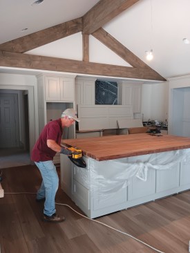

Cordless belt sanders are heavier than corded models, but the author found that both sanders were well-balanced and benefited from the extra weight on certain tasks, such as smoothing out the surface of this walnut butcher-block countertop.

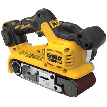

DeWalt DCW220B Surface feet/min. = 650 to 1,050; Belt size: 3 inches by 21 inches; Weight (tool only): 7.7 pounds; Price (tool only): $300; dewalt.com

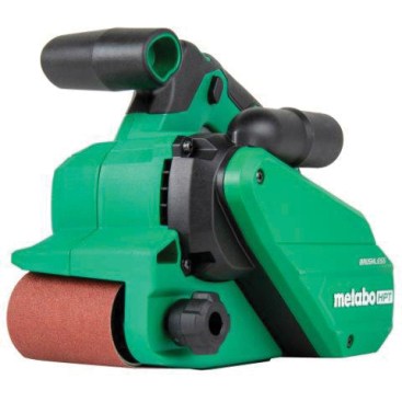

Metabo HPT SB3608DAQ4 Surface feet/min. = 400 to 1,475; Belt size: 3 inches by 21 inches; Weight (tool only): 7.7 pounds; Price (tool only): $170; metabo-hpt.com

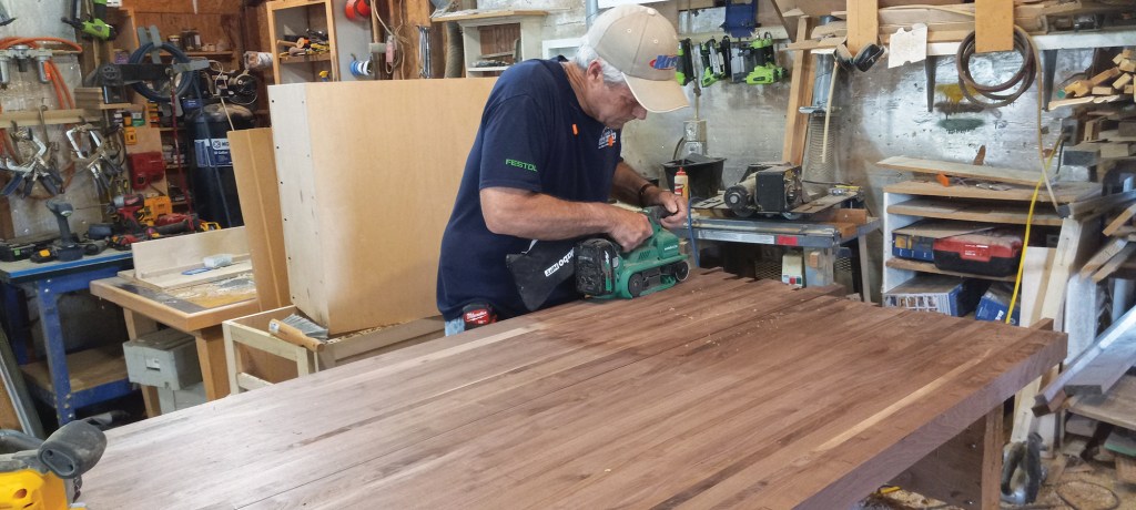

Belt tracking. Tracking means that the belt stays centered without adjustments no matter what is being sanded. We put this feature to the test on a 5-by-8-foot walnut butcher-block countertop that we had glued up and needed to sand the edges and ends of to get rid of saw kerfs and clamp marks. Any time you sand something less than the width of the belt (the slab measured about 2 inches thick), it can make the belt wander and tear up the belt edge. I used both sanders for this task, pushing hard on the walnut edges, and experienced no tracking problems at all.
Balance. The walnut butcher-block top was way too wide to run through my planer in one piece, so I had to build it in three sections and glue and clamp them together. That left me with two 8-foot-long joints to sand on a very expensive project. A well-balanced sander is the fastest way to evenly remove material for a task like this, but poor balance can ruin a project by leaving grooves (we call it digging a hole) that show up when the painter or finisher starts to work.
To sand these long joints, I start by flattening the joint with the belt sander held at an angle, then go back and remove the cross-grain scratches by sanding parallel with the joint. As I do this, I feather out 4 to 5 inches from the joint on both sides, which leaves very little sawdust on the surface. In my testing, both machines did a good job of smoothing out the joints enough that they needed only a few quick passes with a random orbit sander afterward.
Both sanders proved to be well-balanced, and while the weight of the sanders (due to their batteries) was a little challenging for edge sanding, the extra weight was actually helpful for a job like this countertop. I would rather deal with the weight than a cord, and it was especially nice not having to worry about running over a power cord when working with this expensive material.
Edge-sanding material that’s thinner than the belt sanders’ 3-inch-wide belts tests their tracking ability; the author found that the belts on both machines stayed centered without adjustments.

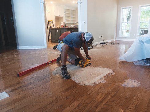

Power. One of the most demanding tasks we worked on with these two tools was sanding high spots out of a floor on a remodel job. I outfitted both sanders with new, 50-grit belts and started my guys sanding with fully charged batteries. I equipped the DeWalt with the company’s Flexvolt 20V/60V Max 9.0-Ah battery, and the Metabo HPT with an 18-volt 8.0-Ah LiHD battery, and asked my crew to keep track of how long they could sand using heavy pressure on the sanders to remove maximum material. This wasn’t a perfect test, as they had to stop to check their work with a straightedge occasionally, but they found that both sanders would run at full power for 15 to 20 minutes of heavy sanding on a battery charge, not quite enough time for a spare battery to totally charge up. The dust bags on both units filled up without leaving excessive dust on the floor.
Both sanders had plenty of power and runtime to tackle tough tasks such as sanding down high spots on hardwood flooring.
