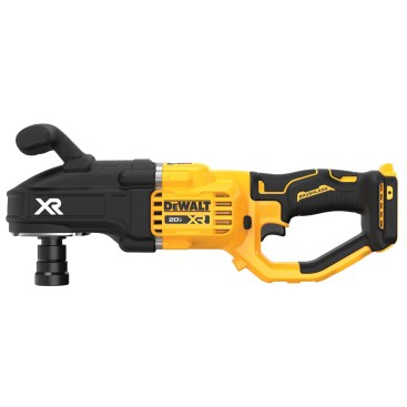

The DeWalt Stud and Joist Drill is part of DeWalt’s XR line of tools within the larger 20V Max platform. We were able to power the drill with our existing DeWalt Flexvolt batteries, but this particular model drill is optimized to work with the 20V XR series battery. Our drill was fitted with a 7/16-inch hex quick-change chuck that requires compatible drill bits. Another version of the drill (model DCD444B) is fitted with a conventional 1/2-inch keyed chuck and is designed specifically for use with Flexvolt batteries. We did not test that model.

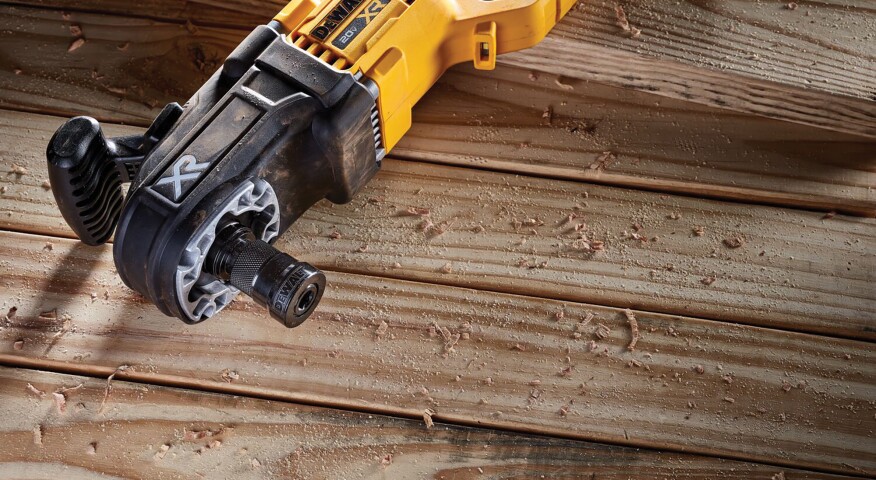

DeWalt’s 20-volt DCD443B right-angle drill has an electric clutch to prevent the powerful brushless motor from kicking back if the bit binds up and a 7/16-inch hex quick-change chuck. The drill is also available with a 1/2-inch keyed chuck.

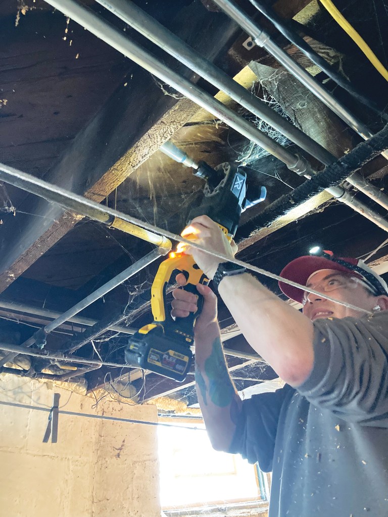

In addition to testing the drill on some typical carpentry tasks, we used it on a bathroom remodel project, where we had to change the rough-in locations for all of the fixtures. This job required several 5-inch-diameter holes to be drilled in LVLs and 2×10 joists, a challenge for any drill. One thing we noted right away was that the drill’s light weight of 8.75 pounds and compact length made it easy to maneuver in the tight joist cavities of the bathroom remodel. When we handed it off to our plumber to give it a spin, he noted that the drill had plenty of power and the brushless motor did not bog down or engage the E-clutch while drilling the 5-inch holes. He also liked the LED light but pointed out that the drill’s lack of a rafter hook would make it challenging to use while working off a ladder.
