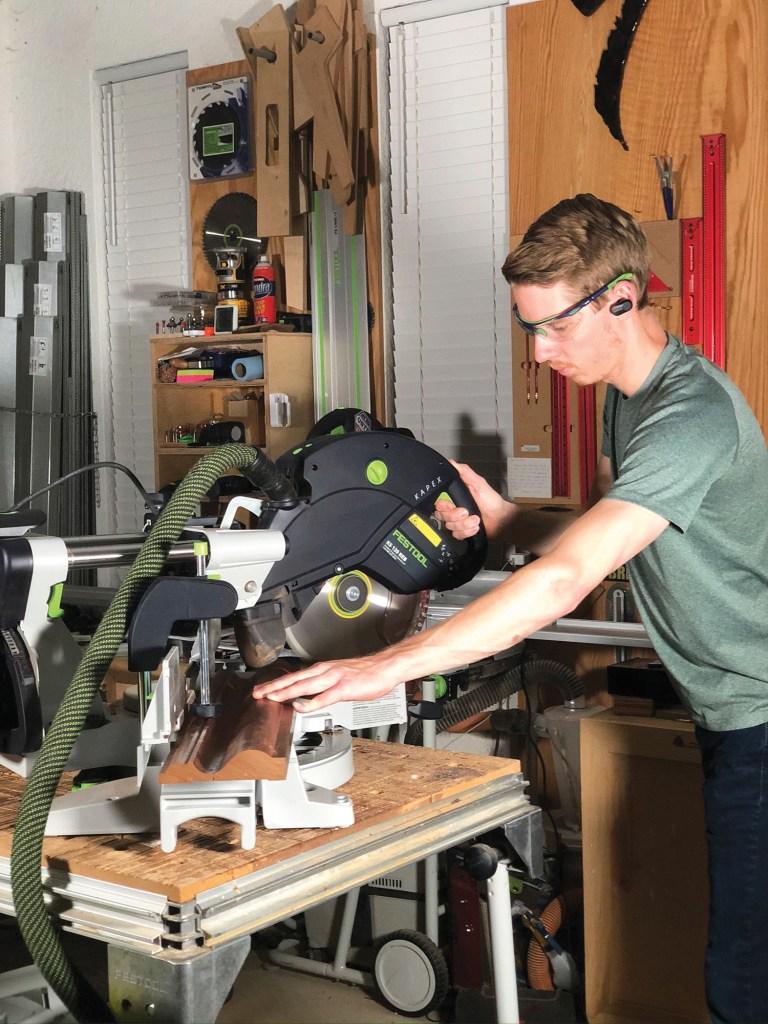

Festool first released the Kapex 10 1/4-inch sliding compound miter saw in 2008, and I’ve owned and used one on an almost daily basis since 2018. I’m admittedly a big fan, so last year, when the company rolled out the latest version of the saw, the KS 120 REB, I was eager to test it and find out how it compared with the older one. With an ergonomic vertical handle and lime-green accents, the new saw sure does capture your attention … but so does the $1,500 price tag.

The latest version of Festool’s Kapex 10 1/4-inch sliding compound miter saw, the KS120 REB, has a magnetic rather than an electrical brake, which should result in longer motor life. The base now has slide-out extension wings for better stock support.

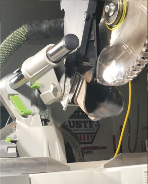

Cleantec locking dust port. A locking port has been added to the saw to remove any chance of the vacuum hose accidentally disconnecting from the saw. There is nothing fun about having a disconnect halfway through a cut, and while I like covering myself in man glitter as much as the next carpenter, I like to do it on my own terms.
Introduced late in 2020, the bayonet-style Cleantec port is widely used among other Festool tools, such as track saws and sanders, and accepts either Festool’s 27-mm-diameter hose or its higher-capacity 36-mm-diameter hose (the smaller hose fits inside the port, while the larger size fits over the port). I’ve found that using the shortest length of the larger-diameter hose provides the best dust extraction.
Along with the Cleantec dust port is a new rubber dust hood—or more accurately, a scoop—fitted to the bottom of the shroud covering the blade. This hood does a fantastic job of collecting cutting debris, and it’s nice to have the option of folding it back or removing it altogether for more cutting clearance when needed.
The saw is now equipped with a bayonet-style dust port that is compatible with both 27 mm and 36 mm Cleantec dust extraction hoses.
There's also a removable rubber dust hood that improves the saw’s already outstanding dust collection when the saw is connected to a vacuum system.

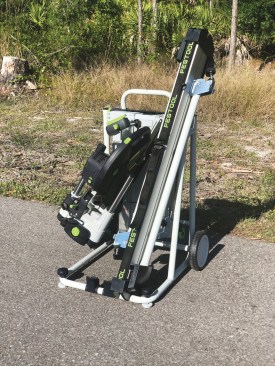

UG Stand and extension wings. Most of my testing was done with the saw clamped to my Festool MFT table, because the new and improved UG stand and extension wing system ($960) were out of stock. When I finally tracked down a set, I was happy to find that Festool has improved on the attachment of the UG wings to the UG stand, with a larger, more robust tab to connect to the base of the saw (the new saw will also work fine with the older stand and wings). A key part of what makes the system so great, the stand weighs only 47 pounds, and it has a very small footprint and wheels that allow you to roll the saw around any jobsite with ease. The wings are designed to fully support material up to 94.5 inches in length. For repetitive cuts, they have integral flip stops, as well as a metric or imperial tape measure (your choice) on both the left and right sides. According to Festool, the crown stops have been redesigned so that they now attach to the wings themselves, rather than to the saw.
The tool-free connection between the new UG stand and extension wings has been redesigned to be more robust.
The assembly can be folded up for transport with the saw still mounted to the stand.

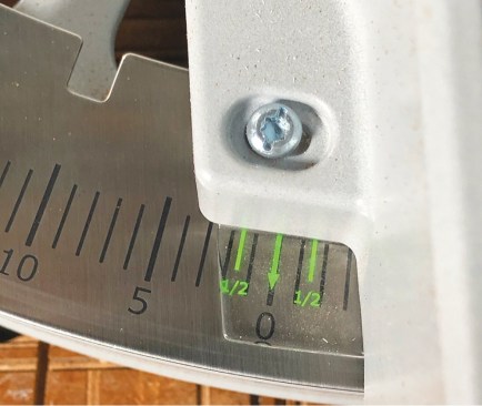

One feature that makes the Kapex unique is the 30-mm rail–forward design, which not only makes the footprint smaller so you can cut with the back of the saw against a wall, but also reduces the blade deflection and head play that are all too common in sliding miter saws. I also like the counter spring balanced bevel adjustment, which allows you to position the bevel at any angle; even when it is not locked in place, the head will stay in position. This makes angle adjustment much less tedious and more accurate. Bevel gauges on both sides with easy-to-read lime-green arrow indicators make it possible to quickly dial the saw in to a fraction of a degree.
The saw’s counter spring balanced bevel adjustment allows you to adjust the bevel at any angle without having to lock the head in place to keep it positioned.
Increments are clearly marked and easy to read.

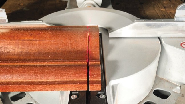

In addition, I really like the fully adjustable dual-line lasers, which accurately define the cut area for precise cut placement. This is another feature that helps me to be deadly accurate with my cuts, yet efficient.

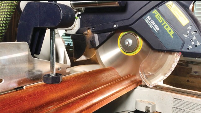

Safety. While many miter saws come with some sort of hold-down clamp, most of them are threaded and—let’s face it—nobody has time to mess with adjusting them. But the Festool clamp features a slick fast-action cam design and an octagon-shaped foot that allows you to quickly and safely secure your workpiece on the left or right side of the blade. I don’t typically use the clamp with basic moldings such as base or casing, but it’s an excellent solution for wide material, or even for cutting extra-short pieces, as it allows you to clamp a sacrificial board to the saw bed.
Powered by the saw rather than by separate batteries, the dual laser lines define both the left and right sides of the cut.
A fast-action hold-down clamp can be used to secure the workpiece to the saw table, resulting in safer and more accurate cuts.
