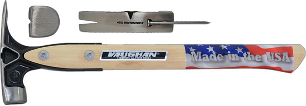

No nails were harmed during the making of this review. The reason is, I haven’t hand-driven a nail in a while. I did use the Vaughn VW18P 18-ounce steel—steel—rip hammer in most of the ways I use hammers, though, so I hope that counts.
I’ve been dropping a titanium slugger in my loop for years and I have few complaints. And after carrying a 20-ounce one-piece, blue-handled steel hammer for years, the lighter titanium was great.
When Vaughn approached me to do a review, I asked for the titanium version, which it turns out, is no longer available. So, steel (Vaughn’s line of steel hammers—Dalluge—is here) it is. OK, let’s give it a whirl.
At 18 ounces, it’s imperceptibly heavier than my titanium-and-hickory “everyday carry” (I stole that phrase from Matt Risinger in this video). At 17 inches long, it’s about the same length too.
The head bolts into the neck of the tool and has a steel overstrike protection plate to support the hickory neck of the hammer. For someone who has broken a titanium striker pulling gun nails on a framing job, this feature—along with the steel shank that slots into the center of the hammer handle—is welcome protection.

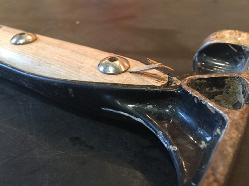

The hardware did come a little loose during the two months or so I had it out deck building and whatnot, and a little piece of wood came off the handle, but that doesn’t bother me. The rest of it is so great, I’m sold on steel.

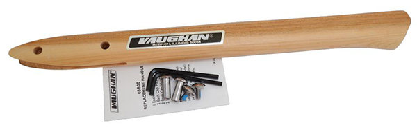

At $75, it’s a great value. Might as well get a replacement handle—it is wood after all—for $25 just to have on the truck.
