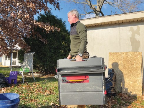

Out of the box. Unlike table saws that ship with stands that require assembly, this one has folding legs that lock and unlock with a push of a bottom. The legs are rock-solid, and the splay keeps the saw stable for ripping long stock. There’s no outfeed support, but that’s not an issue for me since most supports I’ve seen don’t work very well anyway. The saw is very light (Skil says it weighs 51.2 pounds) and has nice, overmold grips to carry it like a tray. On its right side is a handle for carrying it like a satchel; I use that to tie the saw to a bar in my truck so I can store it vertically and free up floor space.

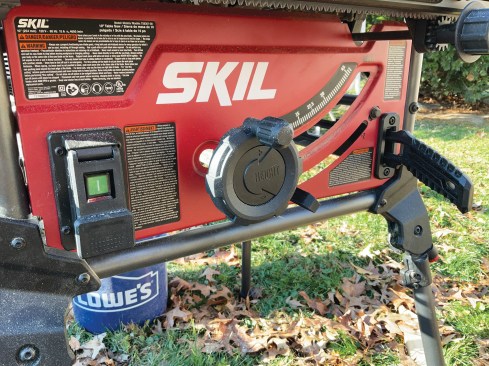

The power switch is a push-button-on/paddle-off setup. The problem is, you have to reach through the paddle switch to turn it on. In doing so, it’s way too easy to immediately turn the tool off if your finger taps the paddle. A simple fix would be to make the “on” opening wider. I think many users may remove the paddle in real life; instead, I lift the paddle a little to hit the on button. It works, and I won’t be tempted to modify the tool.
The author found that the paddle-off switch sometimes interfered with the smaller, push-button power-on switch.
The unit has—and I love this—an electric brake that works at least 50% to 75% of the time. This may be a function of the fact that I got an early model, but that it works at all is awesome: 50% of electric brake is 100% better than no electric brake at all.

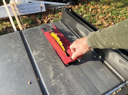

The plastic throat plate locks into the table and releases with the push of a button, so it stays put instead of ending up on the floor of my truck. The included push stick has dedicated storage, so when I carry the table saw like a tray, or store it in the truck, the push stick doesn’t wiggle loose or fall out.
The saw has a plastic throat plate that locks securely into place.

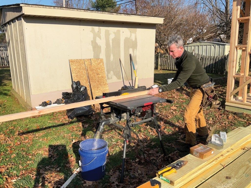

Power and performance. Despite its light weight, the saw hits like a heavyweight and can suck all the amps out of a 15-amp breaker (ask me how I know). It has a maximum cutting depth of 3 1/2 inches, which enables me to plow through 4-by stock, and has the power to do it if it has enough juice. I’ve used it to bevel 2×6 stock for barn sash windowsills at a full-depth 12-degree bevel and to rip 5/4 pressure treated stock to width for a deck renovation. On that project, it easily handled the extra 2x8s that needed to be ripped to 2x4s. Even maple 1-by stock for a kitchen remodel was no match for this tool.
Dust collection. The blade is housed, so sawdust and shavings go down and out instead of flying all over the place. A 22.5-degree elbow directs the dust down; on a shed for which I did a good bit of ripping, I shot the dust into a 5-gallon bucket and, by volume, captured 10 gallons of dust. The chute can clog up, especially with long rips in wet treated deck boards, but not that often.

Weighing about 50 pounds and fitted with a molded handle, the saw has a compact footprint and is light enough for one-handed transport.
