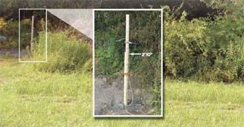

Once both ends are supported at roughly the right level, unclip both ends and let the liquid find its own level. From here, you can measure up or down from a reference mark and transfer that measurement to the other end of whatever you’re leveling. However, I prefer to slide the tubing up or down until the meniscus lines up with whatever I’m trying to level, and then I head over to the other end and make my mark (Figure 4). The latter approach is foolproof and eliminates measuring mistakes: My favorite screw-up is holding my tape on the one-inch mark at one end but forgetting to do that on the other.
Figure 4. Marking directly from the fluid level is the most accurate approach to using a water level. However, you can also clamp the first end at a convenient height and measure up or down to the target level. Then, on the end whose level you’re setting, just measure the same distance and mark.
