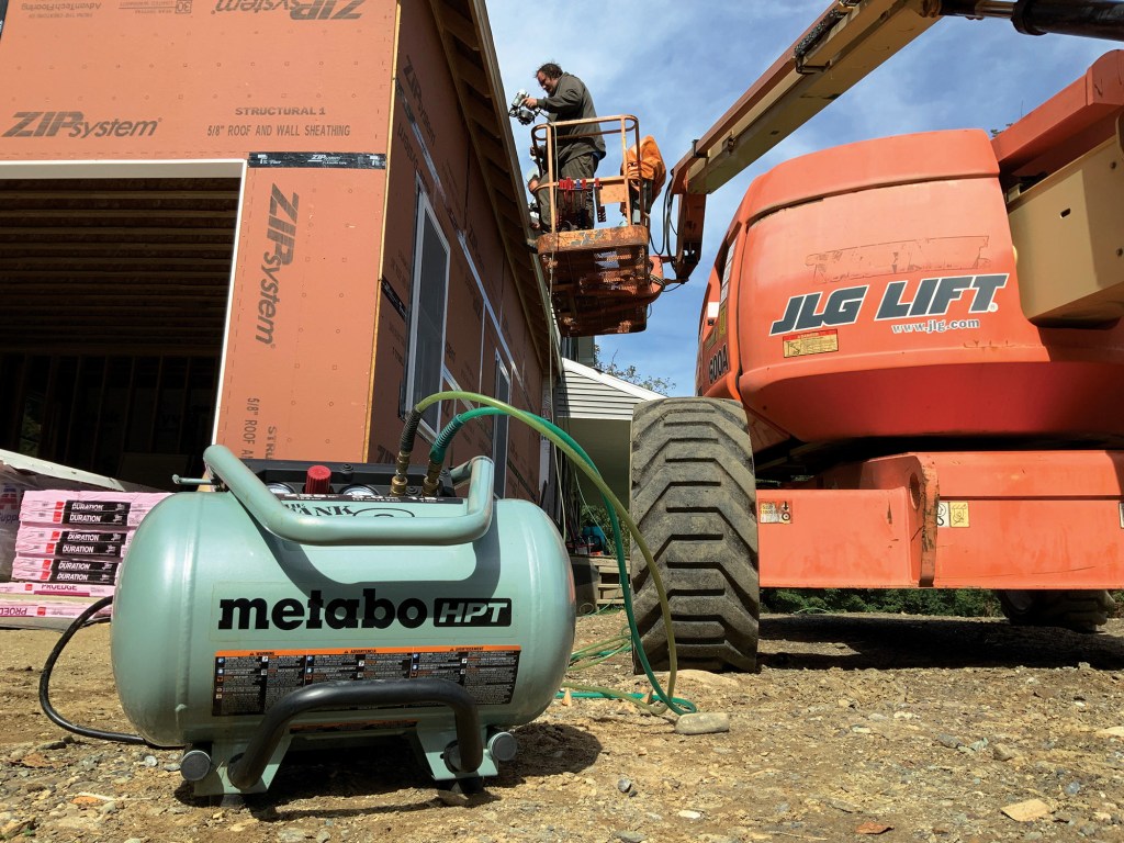

With multiple nail guns in action, the author would typically need to use a gas compressor on this site, but the Metabo HPT EC1315S 8-gallon portable compressor suits his needs perfectly.

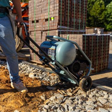

We still use a compressor to power positive placement and framing nailers, as well as roofing, flooring, and coiled siding nailers for clapboards. Having one that is somewhat mobile and not too large is important to us. Although the Metabo is a little heavy—at 93 pounds—for one person to load into a work van or trailer, when stood upright, it fits in well with our other equipment.

Performance. In use, it held all the air we needed to run two nailers of any kind without continuously kicking on and off. In our experience, 5 cfm at 90 psi is pretty good for a portable electric. In our testing, the compressor went from zero to shut off (225 psi) in a little over three minutes. During operation, recharging from 175 psi to 225 psi took about 39 seconds. At a reported 76 dB, it is noticeably quieter than our gas compressor.

The rubber tires and metal handle feel sturdy and well built. We would, however, like to see the drain valve more accessible toward the outside without the user having to flip the compressor upright. And I would also love to have some type of holder for an air hose and connections; what stays attached to the compressor won’t get forgotten and left on a nearby shelf.
