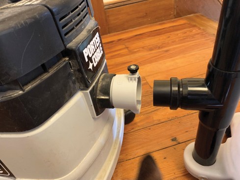

Assembling the unit simply required screwing casters to the base and connecting the exhaust to the vacuum’s inlet port using 1 1/2-inch PVC pipe. All the fittings necessary to make a rigid connection with almost any shop vacuum were included in the box, as was a self-adhesive template that ensured I cut the vertical pipe in exactly the right places. The pipe fittings are pressure-fit, not glued, so if anyone wanted to use the Mullet with more than one vac, they could order an extra pipe from the manufacturer or use standard 1 1/2-inch Schedule 40.
Wheeling the conjoined twins around the work site was no problem—the integrated outlet pipe on top made a perfect handle—and separating them for transport required only the turn of a thumbscrew.
A simple thumbscrew connects and disconnects the Mullet from the vacuum with ease.

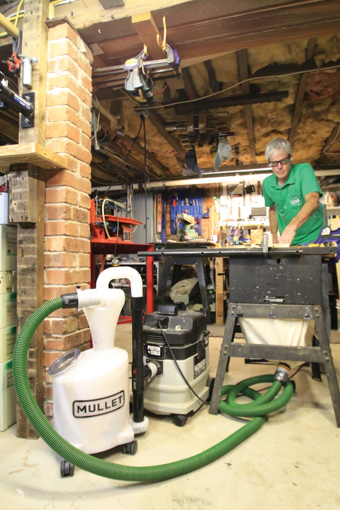

Does it suck? I put this device through rigorous testing in my home shop and on various jobsites. Freed from concerns about running up the costs mentioned previously, I soon found myself breaking out the vac when the day before I might have reached for a broom, or settled for a tool-mounted dust bag, or cut the MDF in the driveway.
Inserting a middleman into the dust collection process never resulted in any noticeable loss of suction, even when the 5-gallon dump bin was filled to the brim. After I had twice emptied the bin, the dust bag in my vac felt as empty as when I started testing.

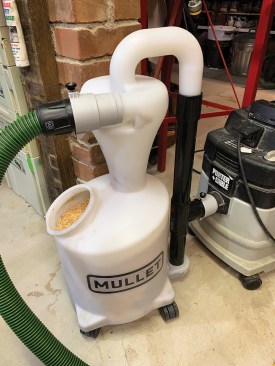

Every time the 5-gallon-capacity dump bin fills up, a dust bag lives to fight another day.
When full, the bin is emptied by unscrewing the lid and pouring the contents into a trash bag. To prevent dust from escaping, Bell suggested using a rubber band or duct tape to fasten the trash bag over the opening or adding water to make a slurry. When a torrential rainstorm flooded my normally dry shop space, I was glad to find out that the Mullet also excels at wet vacuuming.
