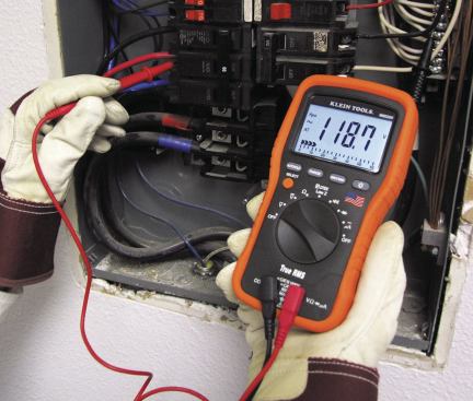

A protective orange cover fits snugly around the meter body to protect it from damage. According to the manufacturer, the meter has a 10-foot fall rating. I dropped it several times onto concrete from an electrical panel and test bench, with no visible or functional damage. The protective casing also incorporates a well-constructed stand. An optional magnetic bracket is available to hang the meter on vertical metal surfaces, such as an electrical panel door.

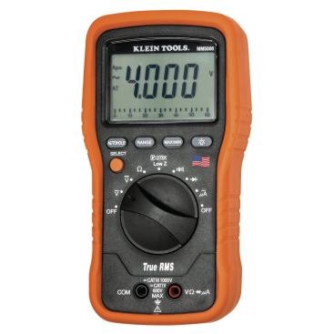

The meter leads insert firmly into the meter plugs—although I would prefer them to be farther apart for easier access with gloved hands. The meter-selector switch operates smoothly with positive engagement at each selection and has the added advantage of two “off” positions. I have wondered for years why more manufacturers do not incorporate this feature.

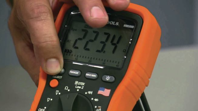

The backlit digital display is large and clear and is easy to read in both dim light and bright sunshine. The viewing angle of the display is good except when the backlight is on and one looks at the display from above. At certain angles, the screen is essentially unreadable, forcing the user to change position or move the meter. Because the meter is often positioned below the user (inside an electrical panel or on a bench), this can be annoying.
The meter has all the key functionality required by an electrician, such as A/C and D/C voltage, ohms, and audible continuity. However, the MM5000 model does not have mA or amp measurement capabilities and therefore may not be suitable for work with control systems. For that, you should consider buying the MM6000.
The meter has true RMS measurement, ensuring that it is suitable for use where there is sine wave distortion (for example, motor VFDs, high-efficiency HVAC, and installations with significant electronic loads).
