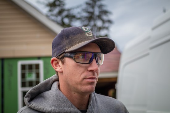

Shifter. This frame comes with two lenses: clear and, in my case, brown (the other option is clear and smoke). We’ve found that the brown lens pops in really easily, but it took more pressure to put the clear lenses on. This setup at $120 is the most cost effective of the styles we tried out.
The frame is very comfortable and the frame doesn’t pinch anywhere. We also found that the wrap-around style results in unobstructed viewing.

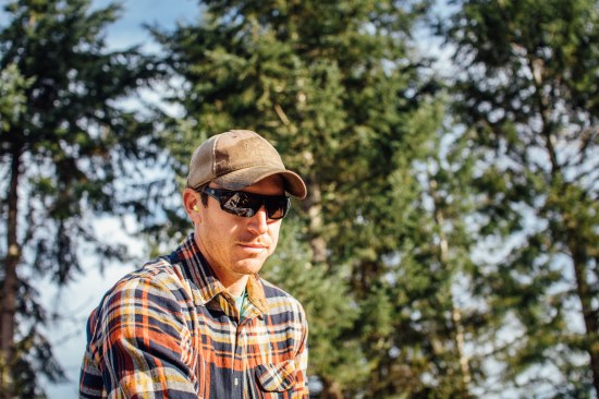

Vortex. We wore this style with clear lenses and smoke lenses. They are so lightweight that at first I felt uncomfortable. I am used to the Harley Davidson clear glasses I had previously written about and those frames are on the heavy side. After wearing them for awhile, I came to really love wearing the Vortex. I can just barely see the edges of the frames, which isn’t a big deal. I absolutely love how lightweight they are.
The lens wrap around so my eyes are very well protected. I love these glasses, but at $140, they may not be for everyone, especially if you need both clear and sunglasses. Another point in favor of these glasses is they meet military MIL-PRF-32432 (gl) specifications.

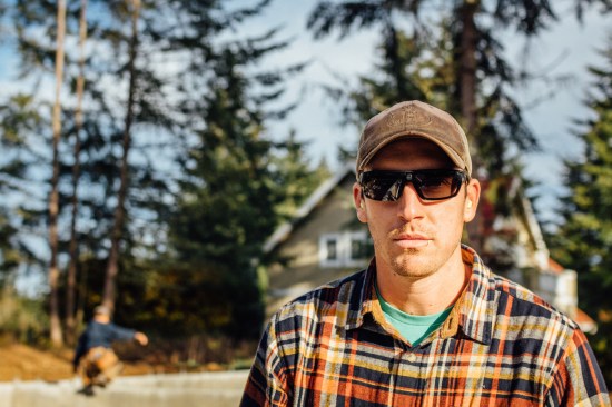

Shield. This frame comes in three color combinations; I ordered the white frame with the blue smoke lenses. First off, these are super comfortable, and they don’t slip when I’m sweating. The lenses are super sharp; they seem sharper than the others and honestly seem sharper than any sunglasses I’ve owned. Each time I put them on, I notice this. I don’t know that they are sharper; maybe it is just that the color of the lenses provides different or better contrast.
One thing I liked about this frame especially is that once I’m wearing them, I forget they are on. I barely feel them and there is zero obstruction from the frame, unless I try to stare at my nose and cross my eyes. Then I can see a little bit of the nose pad.
These cost about $140, and if you don’t mind looking a little like you should be at a European night club (which I usually don’t), I highly recommend them. I did notice that when I smiled, they lifted slightly, but I’ve been told my cheeks are a little above average in size.

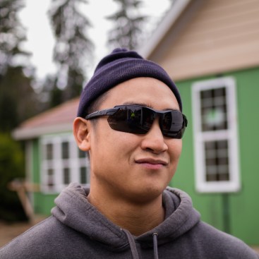

Rampart. I ordered the brown frame with a dark green polarized lens. This frame is very similar to the Homeland but has the Z87 stamp. I love everything about this frame and lens. It is very lightweight, and it looks good. The Shield glasses are great, but the style might not be for everyone.
This frame at $140 is totally worth it. You can wear it on the jobsite or for sporting activities, and it doesn’t look like safety glasses. It doesn’t slide off my face while I’m working in the heat, and it doesn’t pinch anywhere.
