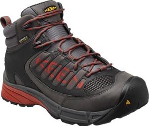

Keen Aurora Mid
This steel-toe waterproof boot is the lightest work boot the company makes. Keen describes it as a medium duty boot. Like other safety toe boots from Keen, the toe caps (steel, composition, or aluminum) are asymmetric. Using different shapes in the lefts and rights is supposed to make for a roomier more comfortable fit at the toes. And it does; wearing the Auroras I couldn’t feel the edges of the steel toes like I have in some other boots. The rubber comes up over the toe cap and keeps it from wearing through, as sometimes happens with steel toe boots. The upper is abrasion-resistant ripstop nylon.
The boots arrived right before I went east for a couple of weeks of volunteer work. I took them with me even though they weren’t broken in. It wasn’t a problem; I wore them every day for two weeks and they were very comfortable—even though the jobsite had concrete floors. Using the pedometer app on my phone, I found I was averaging 7 miles of walking per day—without any blisters or sore spots.
The Aurora looks like a hiking boot and I occasionally forget it has a steel toe. I like them a lot and sometimes wear them on weekend hiking trips. These boots are made in China and sell for about $160.
