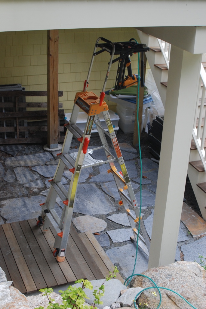

The Select Step can do quite a bit. At it’s most basic, it’s an aluminum stepladder that can be adjusted to a height of approximately five, six, seven, or eight feet. Unlike the traditional Little Giant Ladder with its awkward pin system, the locking mechanisms on the Select Step are simple and very user-friendly. One side moves when two locking handles are pressed in and the other side unlocks with the twist of a large handle. The sliding motion is smooth and it’s easy to locate and lock in the different stops up and down the rungs.
The ladder legs can also be adjusted to different lengths which allows you to set it up on stairs, a ramp, or hard against a wall. One of my electricians, who was hanging lights, really appreciated this feature, especially with the large pendent hanging in the stairwell.

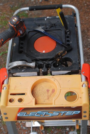

The Select Step also comes with something called the AirDeck. It’s a multi-position tool tray that can be attached to the top of the ladder. In one position, it sits horizontally and in the other configuration, it sticks up from the top of the ladder and acts as a handrail. Even in this vertical position, the platform can be pivoted to horizontal to you still have a place to put your tools. When not in use, the tray clicks into the ladder for easy storage.
The great thing is that the AirDeck provides enough tool storage that once you go up on the ladder, you may not need to ever come down. It has 14 different tool holes, a magnetized tray, a spot for a paint can and two notches that are designed to secure extension cords or air hoses. This is all in addition to the standard storage at the top of the ladder itself.
