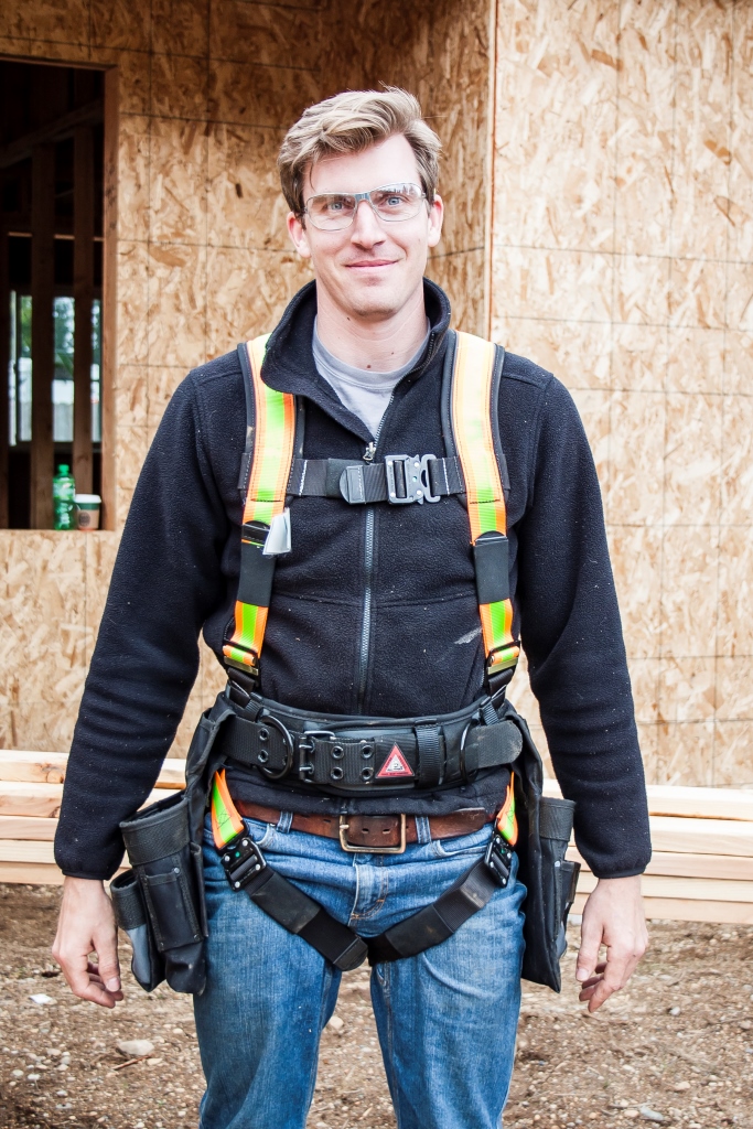

Super Anchor Deluxe Tool Bag Harness
This harness has been designed to be both comfortable and functional.  It includes an attached set of nail bags so if you buy this kit you’ll have your bags and harness in one shot. The D rings on the back and the belt are small enough to be unobtrusive, but large enough to make it easy to connect to an anchor.  I like how the two rings on the belt can be folded to the side and tucked away when not in use. The shoulders and back straps are extremely comfortable; they’re padded and don’t have any edges to them like the straps on more basic harnesses do. And the straps are designed not to absorb moisture—an advantage in wet climates like ours or in hot climates where a harness that absorbs sweat will begin to stink. All the connections are quick-connect and there are replaceable webbing keepers to hold the extra length of strap against the frame of the harness. This harness is easy to inspect because there are tags that show you where to look and a tag behind one of the straps to record when inspections were made.
I like this harness because it’s comfortable and easy to use.  It is light enough not to be bothersome and the straps didn’t chafe around my shoulders.  My only complaint is about the chest strap—which can only be adjusted looser or tighter. It can’t be adjusted up or down so after a couple of hours I found that my nipples were really sore (my crew laughed at me when I complained about it). The nail bags are functional but not “framer specific” so I couldn’t get used to them. They are too deep and the pouch where I would put my tape didn’t form to my tape which made it difficult to put my tape back and really slowed me down. It might be different for other framers or different trades.
The Super Anchor Deluxe Tool Bag Harness is great if it fits you correctly and you like the bags. If the chest strap could be adjusted up and down I’d be happy to use this rig—though I’d replace the bags with my preferred style of Occidental bags—and just hang them from the belt. Better yet, I’d buy the version that does not include bags and add my own.
The harness is available in multiple colors and configurations. We had hi-vis with bags (6151H). The company also makes them in red, silver, pink, and a couple of different camo colors. They’re available in small, large, large-long X-large, and with and without bags. The harness I tested includes bags and goes for about $360 online. That’s a lot to spend, but look at it this way: it keeps you safe and will last many years longer than a pair of boots.
