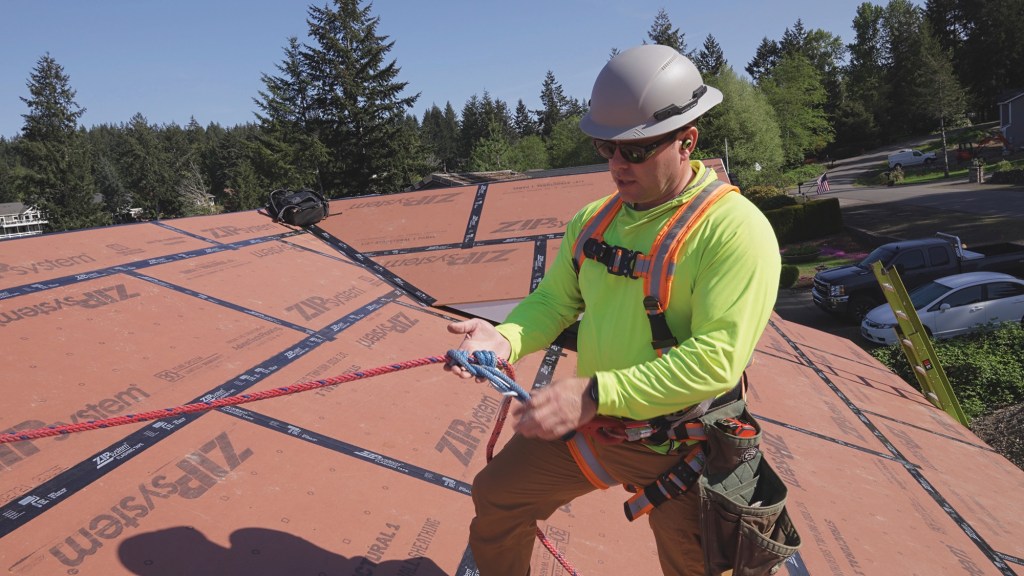

With all of that as prelude, is this hard hat comfortable? I received three samples, and my crew and I wore them for several weeks as we lifted exterior walls with our telescoping forklift (when local safety rules require hard hats in the presence of an overhead hazard) and when we framed interior walls (even when they weren’t required). We didn’t have to wear them every day, but we did anyway.
I can say I have never worn a hard hat as comfortable as this one. It has a slightly lower profile than others I’ve worn, has good air circulation because of the vents (unvented models for cold-weather work are available), and has a built-in sweatband that works well. The hat didn’t wobble or fall off when we were bent over framing walls, and we didn’t have to crank it super-tight to keep it in place. And I think it made me look cool. At $150, it isn’t cheap, but I think that the safety factor, comfort, and style that it offers make it well worth the cost. wavecel.com
