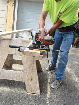

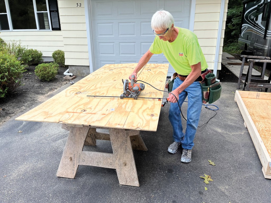

In use. To test the guide and plate, I made crosscuts and rip cuts in different thicknesses of sheathing as well as in some 2-by stock using both the 5-inch and 8-inch roller heads, as well as the two different length bars that the roller heads attach to. The shorter bar allowed for up to about a 13-inch rip from both saws, depending on which side I fed the guide into the plate. With the longer bar, I could easily rip a 4-foot-wide sheet of plywood in half.
The longer guide bar with the wider, 10-roller head provides excellent control of the saw. I used the smaller head on the shorter guide and had no problem with the shorter rips. Using the wider head with the shorter bar would be helpful for budding carpenters.
The Skateplate has wide rollers that reduce friction and improve accuracy. Rips to the center of a sheet of plywood are possible when a Skateplate is fitted with the optional 10-roller Skateguide with a 34-inch bar.

When I tried ripping 1/4-inch-thick sheet stock, the rollers dropped below the edge of the panel, which rendered them useless. But I found that by moving the head up to the holes in the bar used for the handle, the rollers worked fine. I’m not sure if the guide was designed for that, but it worked.
All of the narrower rips, as well as a few cuts ripping 2x6s in half, were easily controlled with one hand on the saw. And when I ripped a sheet of PVC, there were no plate marks trailing behind the saw along the cut, as is always the case with an aluminum or dirty base plate.
