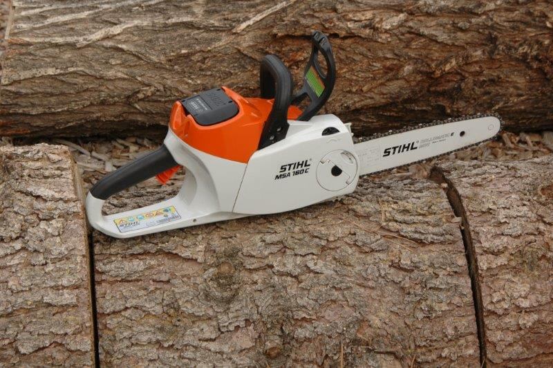

I’ve tested all of the major brands of 36-volt cordless chainsaws available in the U.S. over the last three years, including Makita’s HCU02C1 (see PDB, March 2014), and found that the saw with the best overall performance is Stihl’s MSA160C-BQ. It cuts notably faster and runs longer than competitive cordless models—about twice as long in dry wood and three times longer in green wood. This performance (and the tool’s commensurate cost) is due mainly to three high-end features: an energy-dense 4.5 amp-hour battery pack, a high-efficiency brushless motor, and a thin-kerf bar and chain design that removes less material per cut. The Stihl model also has superior balance and a rear-handle design that keeps your force right in line with the bar for the most control and the least amount of fatigue. While it’s not as easy to use up in a tree as the top-handle Makita saw, which is easily my second favorite cordless chain saw, it’s ideally suited for cutting thick lumber and beams, landscape timbers, and poles and posts for decks, docks, barns, and fences.
