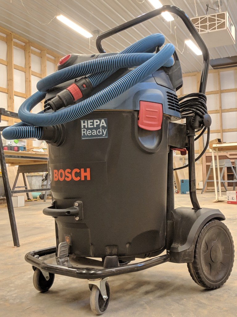

The first thing you’ll notice about the Bosch is its size. It’s the only unit I own that I needn’t bend over to turn on because its power switch is above my waist. The motor and body are swivel-mounted on a heavy-duty frame that allows the collection bucket to be unlocked and tipped for emptying. This is a great feature if you have an area to dump it in.
The wheel set and steel frame make this big vac easily maneuverable. You’d have to make a real effort to tip this over.

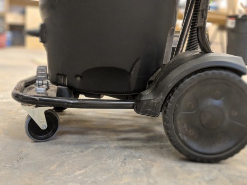

For its size, its surprisingly maneuverable. It’s easily guided by tugging on the hose. This is due to the oversized (they’re the biggest I’ve seen) rear wheels and swiveling front casters. Given its stout design and large footprint, there’s next to no chance of knocking it over. The tubular frame extends well past the top of the vacuum to act as both a cord minder and a top-handle. And, as if being built like a tank wasn’t enough, Bosch molded dual cup holders into the top of the motor for those who like to keep refreshments at hand.

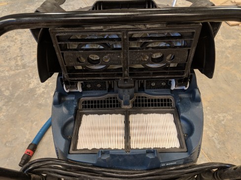

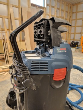

Being able to access the filters without having to take the motorhead off is a godsend.
Another great design feature is the ability to change filters externally. Simply lift a lever on the back and pop open the hood. Why this isn’t standard on all vacuums is beyond me. I’m happy to report that using the auto-clean mode in combination with my Dust Deputy cyclone has kept my filters virtually spotless. I can pull either of them out, slam them onto my bench, and little if any dust will come out. While auto-clean alone can’t keep up with straight-on dust, filters are expensive and every little bit helps to extend their service life.

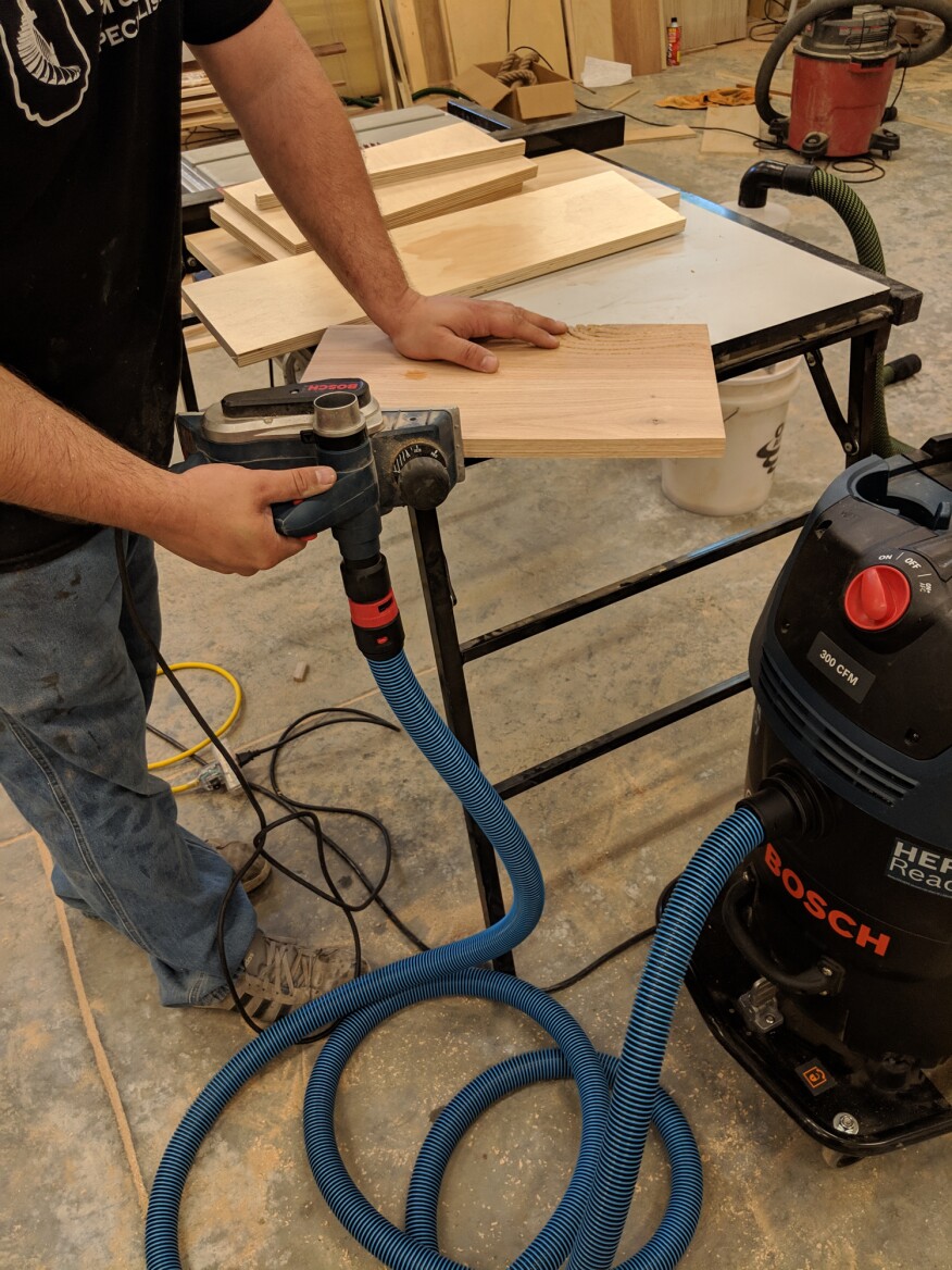

No matter what tool the author used the extractor with—a big chip maker like the planer here or a fine-dust creator like a sander—the auto-clean function kept the filters nearly spotless.

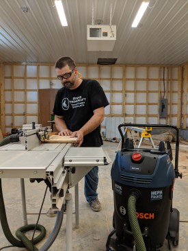

At 300 cfm, this unit has twice the air movement of the author's other extractors. He does rig his own, larger hose up for big chip makers. It opens up the airflow even more for better dust control.

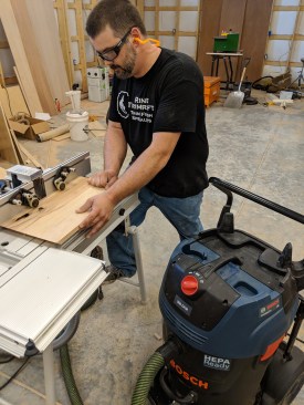

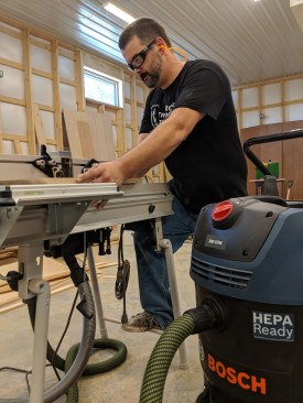

I find that using the extractor with bigger woodworking tools, like my table saw (see Nathan’s review of the Metabo HPT MultiVolt table saw here) and router table, I get better performance switching to one of my own hoses, with a 36mm I.D. with a 39mm I.D. fitting. The slightly larger aperture restricts flow just that much less than the factory-supplied adapter. For tools that produce copious amounts of dust, unrestricted high-volume suction is best.
