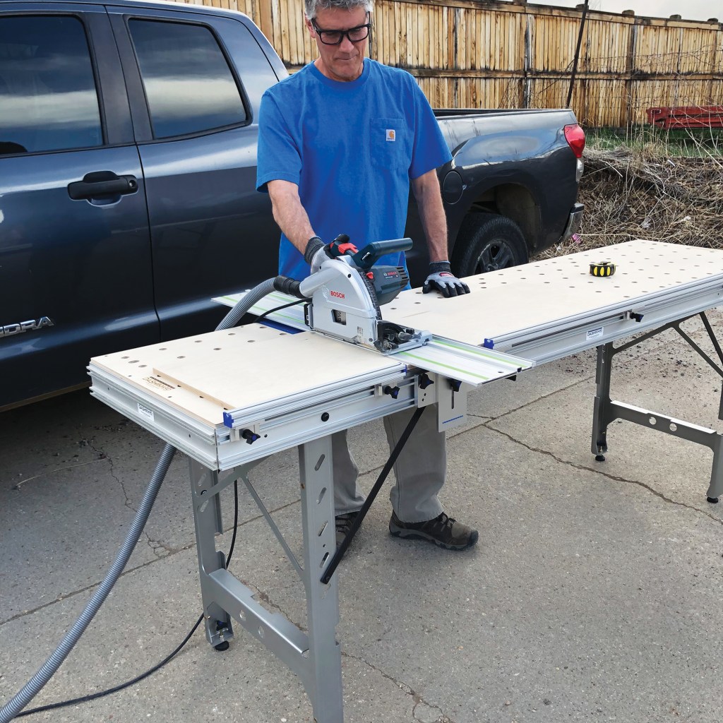

The Dash-Board Portable Workshop is shipped direct from the manufacturer ready to assemble and set up on site. The workbench has a Baltic birch plywood work surface that measures 92 inches long by 23 3/4 inches wide and weighs about 60 pounds as shown.

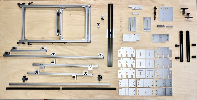

First impressions. My Dash-Board shipment arrived over the course of several days and in quite a few packages, every piece wrapped and padded in a way to avoid any possibility of damage from careless handling. Since I got both the basic bench and the platinum accessory pack, I had a ton of pieces to assemble, but I was able to put them together in one afternoon.
The bench itself comes preassembled and is very sturdy, something severely lacking in the commercially available setups I’ve used. For example, the top is made from Baltic birch plywood instead of MDF, and the amount of extruded aluminum in the frame puts any competitors to shame. At almost 8 feet long and 24 inches wide, it is sized for breaking down sheet goods efficiently while providing full-length material support. Any of the parts that aren’t milled aluminum (parts vary from 1/4 inch to 7/16 inch thick) or extruded aluminum are made from carbon fiber, which is extremely durable and lightweight.
Nathan Rinne The author upgraded the standard bench with the company’s Platinum Pack, which includes a set of guide-rail brackets needed to make crosscuts with a track saw, bench dogs, an assortment of different fences, and other useful accessories.

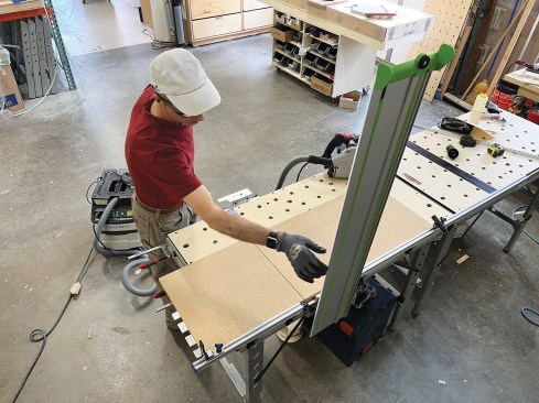

Performance. The Dash-Board is designed to make quick work of breaking down sheet goods. For crosscutting, it has guide-rail brackets made from 1/4-inch plate aluminum that allow you to quickly hinge the track out of the way when you need to move the workpiece, and then simply drop the track back down into a pin on the opposing guide bracket, guaranteeing a square, repetitive cut every time. You accomplish this by squaring the side-mount fences to the track upon initial setup. The two-piece design of the fence ensures material support on both the left and right sides of the cut, which combined with the design of the guide-rail bracket, provides continuous support even at the point of cut. Using the carbon fiber flip stops on the fence makes repeat square cuts an easy task. I find this especially useful in cabinet construction as I can cut all my shelves to exact tolerances without needing to measure anything but the initial shelf.
Crosscuts as wide as 24 3/4 inches are possible when the guide-rail brackets are fitted to a track saw’s guide rail.

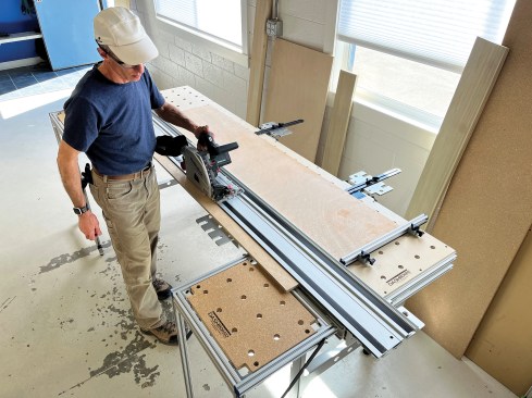

Rip cutting is also an easy task, using the Universal Track Stars and Outriggers. Simply mount the SpiRail Dogs to your track and each of them will slide and drop into the slots on the Track Stars. The various parallel guides and rip gauges allow you to make repetitive rips and quickly break down sheet goods. The Outriggers are a must for material support, but they also help complement the ingenious design that has you cut just to the side of the bench, thereby missing all brackets and accessories with your blade as you do so.
Adding the system’s Outriggers to the workbench provides additional support for ripping sheet goods.

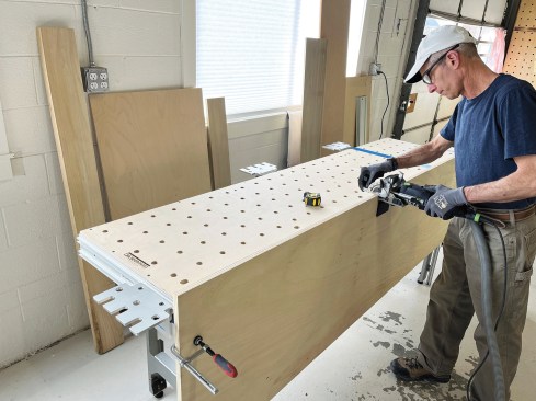

The Dash-Board also functions as an incredible door and panel bench, thanks to a pair of optional door and panel supports that mount to the bench. These allow you to stabilize and clamp a door or panel along the side of the bench and perform any number of drilling, planing, and routing tasks while on the job.
Doors or panels can be clamped vertically to the side of the bench with the addition of optional supports.
