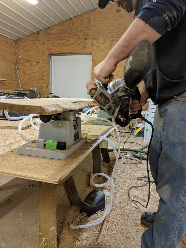

The system is basically a suction cup. A clamping module holds workpieces (up to 65 pounds per head unit) securely via a separate vacuum pump unit connected by a hose. The pump delivers 198 pounds of clamping force with the head sitting level; 121 pounds with the head tilted 90 degrees. Simply set your work onto the vac head, and it automatically clamps it down. To release it, depress the footswitch.

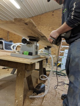

I’ve found that it’s nearly impossible to pull a piece off without disengaging the vacuum. There are four different heads available (three are sold separately) and you can link two head units together with one pump to hold longer or heavier materials. Another awesome feature: With the flip of a switch, you can clamp the head unit down using the vacuum pressure to any nonporous surface. Add to that the unit’s ability to tilt to 90° and swivel a full 360°, and the case makes itself for how much speed this puts on the track for my woodworking jobs.

Planing and sanding cabinet doors and drawers. Routing hinge gains and boring locksets in doors. Edge-forming, sculpting, wood carving, painting, and anything else you can think of (edge-banding, for example, or setting hardware) where having no clamp in your way and the ability to rotate your work 360° is important.

More to the point, the level of efficiency the Festool Vac Clamp offers me is something that doesn’t save only a second here and a minute there. It’s top-to-bottom step minimization or elimination. I don’t need to fuss with clamps at all—no changing, no adjusting. The unit is compact and takes up very little space and sets up in minutes. I’m not tired and distracted from having to clamp and reclamp and clamp again and unclamp and move clamps. And I can use the tool from fabrication to applying finish and hardware. It’s saving time and energy while increasing focus and production all the way through the process.
