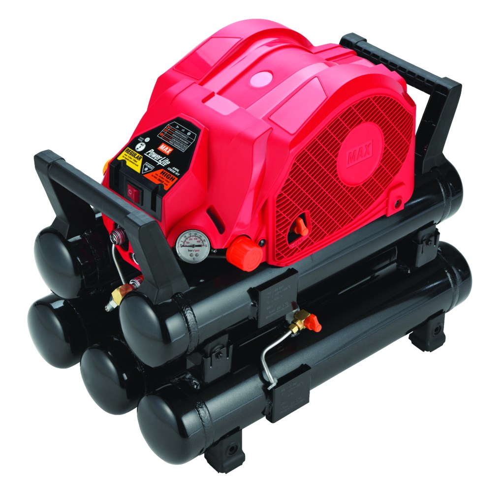

The AKHL1260EX has a brushless motor that runs on 70 volts and has a 5.7-gallon capacity.

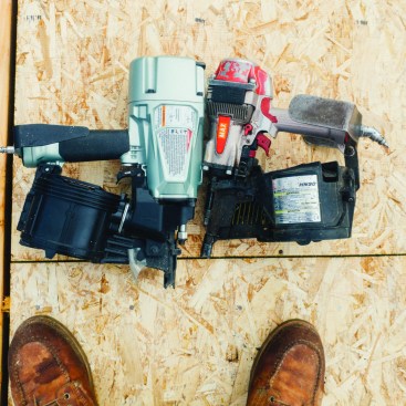

PROS AND CONS OF HIGH-PRESSURE
The benefit to a high-pressure system is the lighter weight of the guns. We have run coil nailers for 15 years and love them. We find that it is easier to clear jams, and there’s less reloading due to the higher capacity. Though more nails means more weight, the high-pressure guns are smaller and lighter to begin with.
The downside is that everything is expensive. The hoses cost more and need to be professionally repaired, due to the high pressure. The compressor is slow but quiet. It will keep up with two people, but not if we are nailing off shear panel, which means a tighter nailing pattern.
A high-pressure nailer (right) is smaller and lighter than a traditional nailer (left).

Max now has available the AKHL1260E compressor, which has been around for quite a while, and the new AKHL1260EX, which I’m reviewing here. The 1260EX is almost identical to the 1260E, but it has a 5.7-gallon capacity versus 2.3 gallons for the 1260E. The compressors both feature two high-pressure and two regular-pressure outputs. We run one regular pressure for a Hitachi positive placement nailer and the two high-pressure for the HN90 coil framers we love so much.
At 50 pounds, the AKHL1260EX compressor is light. In addition, it is quiet, at 67.5 dB in regular mode and 66.4 dB in quiet mode (which runs the compressor at a lower speed). We leave the compressor in our van to keep it out of the weather, and run the hoses from there.
This compressor has a brushless motor on an inverter circuit. The inverter steps down to 70 volts. We can run it off a 100-foot 10/3 extension cord without tripping the breaker. It also works well in the cold.
