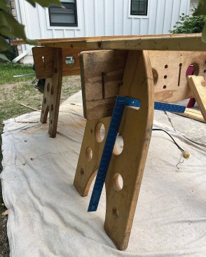

He replaced it with a plywood sawhorse system that can be broken down into flat pieces for transport.

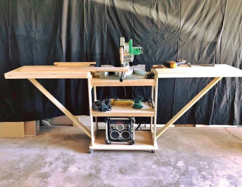

My first foray into making a jobsite workstation came soon after I got my first miter saw and before miter saw stands were commercially available. This first stand (see photo above at left) was a short table on casters with folding wings for stock supports. It did the job but was bulky and took up a lot of room in the truck. Also, the wings weren’t that stable and had limited use as a work surface for other tools. (This is a downside to many commercially available units, too. The supports function perfectly to support the stock, but that’s all they can do.) The main feature I strive for is adaptability. I want a setup that can be configured to fit the space I’m working in and serve as a workstation for a wide variety of tools. Often, my miter saw and small jobsite table saw are central to the setup. But I also need a surface for using a track saw, routers, and a circular saw and doing glue-ups, sanding, and so forth.

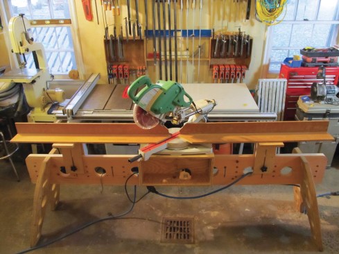

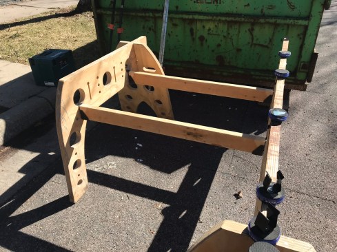

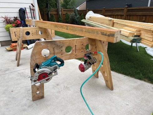

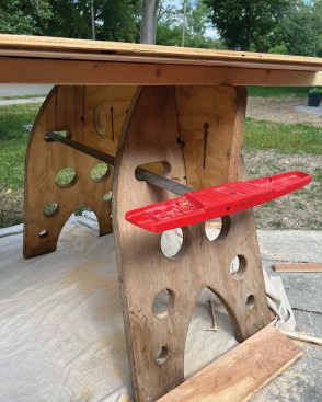

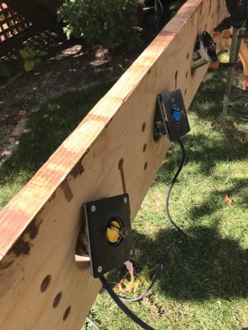

Toward making a more adaptable station that could be broken down flat for easy transport, my next venture was to experiment with the “Tri-horse”—a set of three-legged sawhorses I invented that are made from 3/4-inch plywood (see photo above at right). The rail and legs join with slots so they can be set up quickly. The three-legged design lends a distinct advantage over traditional sawhorses: It won’t rock when placed over uneven terrain. In the middle third of the rail and legs, I cut holes and slots that reduce the weight without compromising strength; provide places to hang and hold tools; and accommodate accessories that extend the functionality of the horses. For example, sawhorse support brackets from Rockler on the ends of 2x4s allow me to connect two different size Tri-horse units together in varying configurations that can expand and contract to accommodate the size stock I’m using and space I have available (see slideshow below). The slots are also helpful when I’m using track saw clamps.

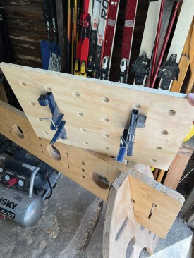

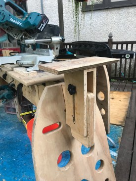

For stock supports, I made “T” brackets from plywood. These have two legs spaced an inch apart so they can be slipped over the top rail, adjusted to the height I need, and tightened in place with a bolt with a star knob inserted through a slot in the rail. These T-brackets come in handy for a variety of other uses, independent of the workstation: I use one to clamp doors on edge when working on either the hinge side or the latch side of a door. I can also use one to hold a vertical length of 2×4 to serve as a “dead man” to support handrail or other material that I need to hold in position at a fixed height to join or scribe.

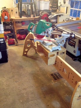

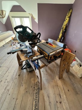

For a table to hold my miter saw on the Tri-horse, I made a “saddle box” from two plywood boxes joined by a piece of plywood on top. I leave a 1-inch slot between the two boxes so the assembly can slip over the top rail of the Tri-horse, creating a small table to support the miter saw (see slideshow). For later versions of this stand, I use clamp brackets from a Trojan Work Center. These work well, though the brackets are no longer readily available. I also add dog holes to the saw table so it can function as an effective work surface for planing and clamping material.

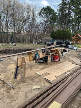

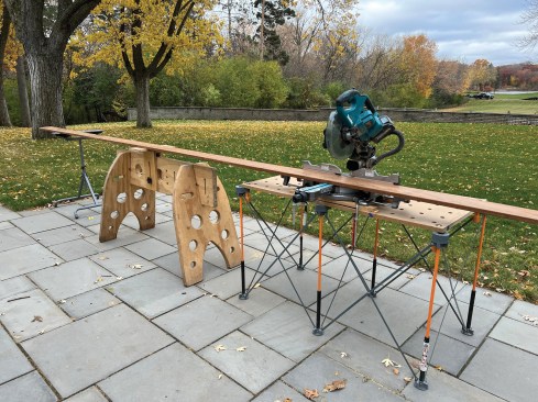

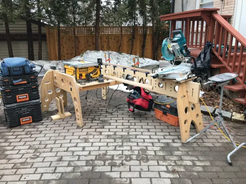

For some jobs, I just need a saw stand, but for most jobs, I want to accommodate a wide range of tools and material sizes or allow other carpenters working with me to use it. Versatility is key in any workstation because I do many different types of jobs. For deck work, where I need stock support for long material, I join two different size Tri-horses end-to-end—overlapping the rails to extend stock support—and supplement with folding roller supports (see slideshow). I don’t like to use roller supports alone with floppy, heavy deck boards because they move around too much; the fixed T-bracket on the Tri-horse rail helps keep the material steady. (Husky makes a folding “glide support” that’s like a roller support but holds long, floppy material steady. I use more heavy-duty ones made by Ridgid, which have been discontinued but can still be found used.)

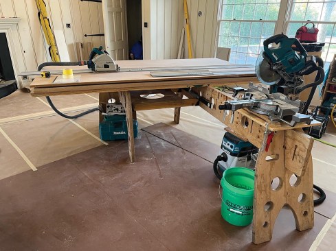

While I typically set up the workstation for a miter saw and a table saw, I can remove the table saw and throw a piece of plywood over the top when I need to create a larger assembly table or a track-saw station .
When I’m working by myself, I usually set up the miter saw and table saw at right angles so I can use either tool without having to take extra steps. When working with this configuration, I try to set up sawhorses behind me to stage my material, so I can turn around and grab it when I need it, without walking too far.

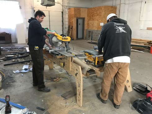

When more than one carpenter needs to access the workstation, I turn the tools so that two people can work without being in each other’s way, and I make sure that both saws shoot sawdust into the same pile (and not on the other guy).

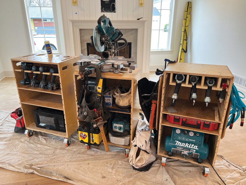

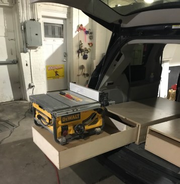

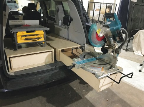

For a small work vehicle, the author built rolling drawers—one the width of a miter saw and one the width of a table saw—that can serve as workstations for small jobs.
