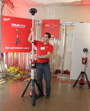

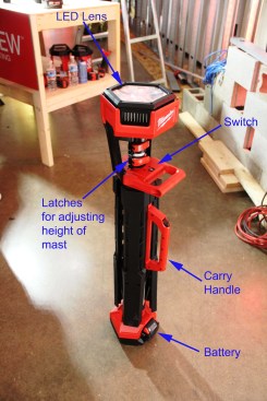

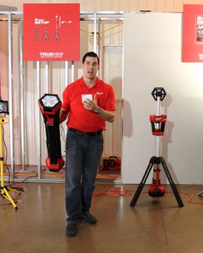

One of the cooler tools I saw at the recent Milwaukee media event was the new M18 Light Stand, a cordless LED light powered by 18-volt tool batteries. The light head tilts 90 degrees and pivots 180 degrees on an extendable mast supported by folding tripod legs—and can be set at any height between 4 and 7 feet above the floor. The legs fold out in a matter of seconds and provide a stable base, in part because the batter was placed at the bottom to lower the center of gravity. With the mast down and the legs folded the Light Stand is compact and easily carried by an integrated handle.
The unit is not as bright as a halogen light stand, but it is more durable, puts out minimal heat, and there are no cords to trip over or deal with. And it stores in less space and so is easier to transport. The Light Stand has multiple power settings and is capable of producing up to 2,000 lumens, making it equivalent to the PowerSmith light Doug Mahoney recently reviewed. It is said to be able to run 4 hours on high and 10 hours on low.
