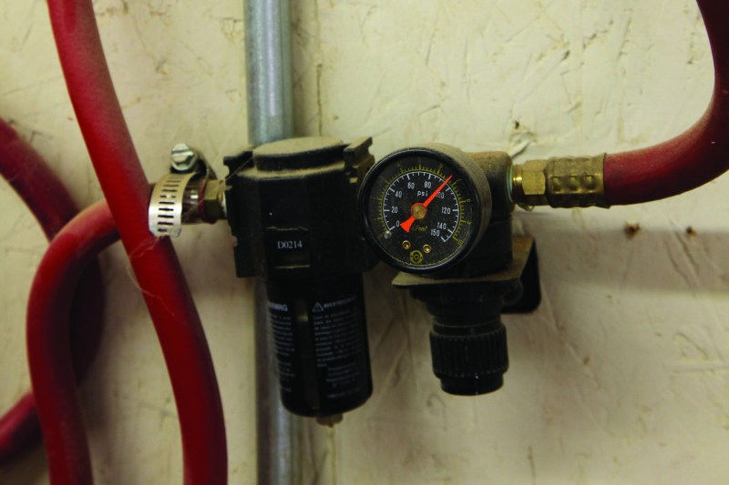

Q:: I’m setting up a small woodworking shop and want to have places to plug in pneumatic tools at various places around the shop. What is the best piping to use for compressed air and do I need to worry about condensation?

In-line pressure regulators are a convenient accessory for tools that require less pressure than the compressor provides.

As far as condensation is concerned, it’s always wise to install condensation filters in a piped system, for several reasons. If you’re planning to use compressed air to spray finishes, it’s difficult to achieve a blemish-free finish if there is any water in the supplied air. Also, pneumatic tools work best and last longer when clean, dry air is used. Finally, moist air can contribute to rust and corrosion in both the compressor and any ferrous metal components in a piped system. Remember to drain the compressor and any in-line filters on a regular basis.
