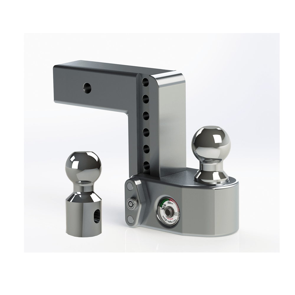

Ideally you would be able to measure tongue weight every time you connect the trailer—which is exactly what the Weigh Safe Drop Hitch is designed to do. The unit consists of an adjustable aluminum drop hitch that installs in the towing vehicle’s receiver. The ball is attached to a “scale” (actually, a load cell) inside the hitch that displays the tongue weight on an integral dial that shows the load in pounds. Every time you connect a trailer you will be able see the tongue weight and know if you need to redistribute or lighten the load. Weigh Safe offers 8 different models—for 2- and 2.5-inch receivers and with drops of 4, 6, 8, and 10 inches. Each includes a 2- and 2 5/16-inch stainless steel ball.
Maximum towing weight varies by ball and receiver, and is between 7,500 and 12,500 pounds. The maximum tongue weight for all models is 1,500 pounds.
