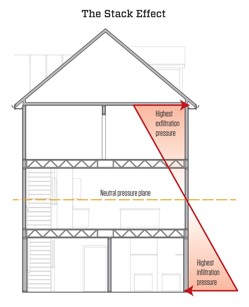

Layers of pressure. As warm air rises inside a typical home, the pressure changes from inward pressure (infiltration) at the bottom of the building to outward pressure (exfiltration) at the top, with a neutral pressure plane in the middle. Because the pressure increases with the distance from the neutral plane, the top and bottom of the building are the most critical for establishing an air barrier.

The Stack Effect
Before we discuss strategies for air-sealing a building, we need to talk about what that building typically experiences in terms of air pressure. Most buildings undergo both infiltration and exfiltration (if not, they would implode or explode). Buildings constantly try to equalize their internal pressure: 1 cfm comes in to equal 1 cfm going out, or vice versa.
Pressure in a building is not arbitrary. On the contrary, it is pretty predictable (see “The Stack Effect” illustration, above). Because warm air rises, the highest exfiltration area is at the top of the house or the upper limits of the air barrier. Consequently, the area of highest infiltration pressure is at the lower limits of the air barrier or the basement. The median of the two is known as the “neutral pressure plane.” The neutral pressure plane sees neither infiltration nor exfiltration, but rather it is the line where the pressure changes direction. Looking at this illustration, the farther you move from the neutral pressure plane, the greater the pressure, and the more critical it is to maintain an airtight barrier. Your air-barrier strategy should start at the points of highest pressure and move towards the neutral pressure plane. This strategy is applicable to both new construction and remodeling.

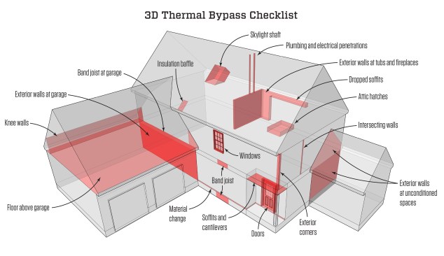

Three-dimensional thermal bypass checklist. Many organizations have published lists of areas in a building that are likely to challenge the air barrier. Making a 3D rendering takes the checklist one step further, giving users a visual graphic to better understand and deal with these areas of concern.
Steve Baczek
The Thermal Bypass Checklist
There are many critical areas where the continuity of an air barrier is likely to be challenged, and many organizations such as Energy Star have compiled extensive lists of those areas; Energy Star calls its list the “Thermal Bypass Checklist.”But for most people, a graphic representation of a checklist like that is the best way to get the point across.
With that in mind, I developed my own three-dimensional version of the checklist to visually illustrate the points where an effective air barrier is most likely to be challenged (see “3D Thermal Bypass Checklist” illustration, above). Instead of being written on a list, the areas of concern are highlighted in a 3D representation of the building. These areas are common to the work that all of us do every day.
But as common as these challenges seem to be, I often see that many of them are not being solved for in our industry. The failures I see most often are where the continuity of the air barrier is broken. The solution for creating a successful air barrier is being able to visualize and think through every inch of the barrier—especially in critical areas—to maintain continuity.
