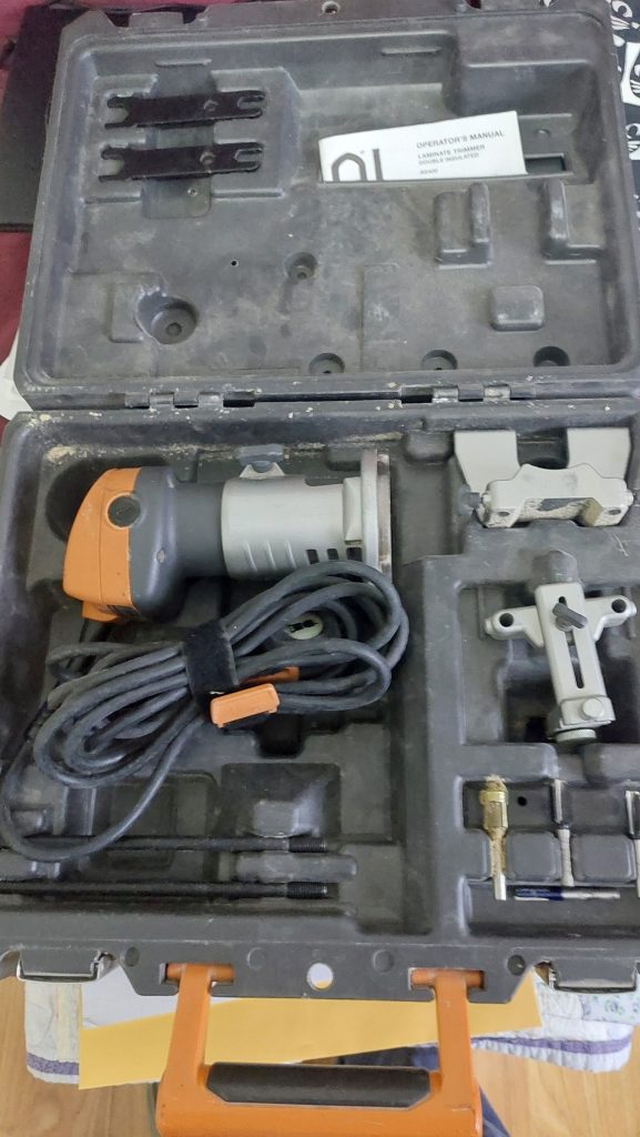

I needed something smaller and more portable, something more suited for onsite or in-place work. The laminate trimmer with its ¼-inch collet, one-handed operation, and modest cost made more sense for what I was doing and what I would be doing going forward.
There were four or five different manufacturers that made this type of tool, so I began comparing features and prices. This isn’t a tool review so I won’t go into the specific details of each model, and the information would be out of date anyway. (This was 2002 and cordless routers were not even on the horizon then!) The general factors though were good balance, soft start (a must), a good view of the cutting area, power, and then price. It would have been nice to have a built-in light on offer, but again this was a while ago and therefore still the dark ages (pun intended).

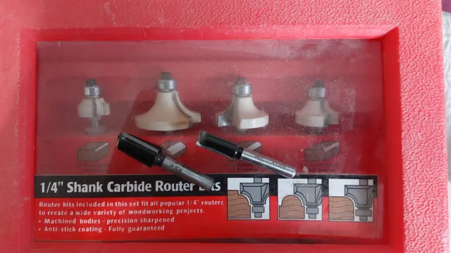

What could I do with the router I bought? Not much until I got a set of bits. Keeping in mind what I would be doing with the router, I purchased a small selection of profile bits (roundover, chamfer, and ogee), along with a couple of straight cutting bits. The other more expensive profiles could wait until I needed them and knew what I was doing.

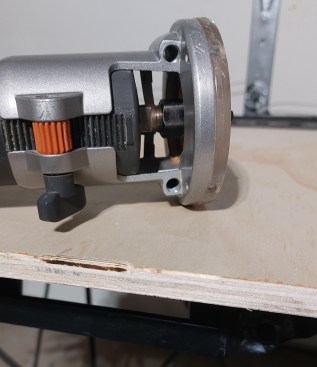

Next, we set the depth. Let’s take the case of recessing for a hinge. I take the hinge and set it flat on the router base and adjust the base until the amount of bit protruding equals the thickness of one hinge leaf. You can also do this with a sliding combination square, or in the case of a jamb or door that has a recess already, use that existing pocket to line up the tool to the depth needed for its new matching side. Note that I am still not connected to power.
Now we power up the tool and run a test on a piece of scrap, confirming with the hinge that the result will be flush. Safety glasses and ear protection are highly recommended. If you are doing a profile this same advice should apply. Test first, as a small change in depth will change the result a lot. When doing the test, and also when doing the actual work, make sure the cutting bit is not in contact with the workpiece when you turn on the power. The edge of the tool base can be held firmly on the work surface, but if the bit is touching at start-up you can get burning or the tool will jump back at you. The “hold firmly” suggestion is because, as the tool spins up, the torque it generates will want to twist the tool in your hand.
On your jamb or door you will have marked the outline of the hinges (after measuring where they need to be located). I do this using the hinge as a template and marking it in pencil. I then go over this line with a knife to help prevent tear-out while routing. Take small passes, about half or less the width of the bit, and work up to the line you want. If you try to push the tool to take out full-bit-width swaths of material, you can bind the tool or overshoot your marks. Don’t be afraid to check with your hinge as you go: If you started small you can still correct any depth issues and go back. Work in small passes left to right until you are done. The left to right is important, particularly if you are new to the tool, because of the direction of spin of the bit. Going with the spin, right to left, can cause the bit to grab and pull itself along the material, potentially going further than you want and burning the wood. This goes for doing a profile on an edge too. Travel around the workpiece counterclockwise or the tool will want to pull you along.

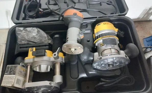

My more expensive kit rarely gets used, and it wasn't purchased until the old one gave me enough confidence and earned the money to pay for it.
