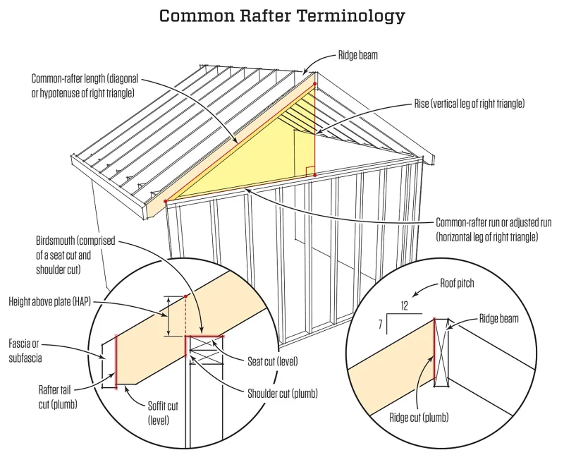

Rafter Terms
A common rafter has three basic parts you need to become familiar with:
  • Plumb cut, typically called the ridge cut, at the top end of the rafter.
  • Birdsmouth, which consists of two cuts – a horizontal seat cut and a vertical shoulder cut.
  • Tail cut, which may be cut plumb or square, depending on how the eaves are detailed.
Locate these rafter terms in the illustration below:

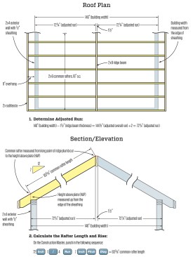

To lay out a rafter, you need to know the roof slope and calculate the rafter run:
Roof slope is the incline of the roof, expressed as a ratio of the number of inches of rise (vertical travel) for every foot of run (horizontal travel). In our example, we have a 7:12 roof—7 inches of rise for every foot of run. On construction calculators, slope is often called “pitch.”
Rafter run is the horizontal distance the rafter travels. On a full gable roof, this is equal to half the building width minus half the ridge thickness.
Calculating Rafter Length
The calculation sequence to find rafter length on a Construction Master is shown below.
Note that rafter length is measured from the tip of a plumb cut at the top end of the rafter (ridge cut) to the building line (shown as a dotted red line in the Section/Elevation below). Rafter length does not include the rafter overhang.
For a detailed explanation of how to run this type of calculation on the Construction Master, watch the video here.

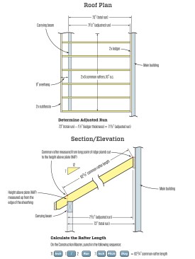

On a shed roof, rafter run is the distance from a ledger on the main building to the outside of an addition wall or porch carrying beam. We need to adjust the total run (73 inches in our example) by subtracting 1 1/2 inches, the full thickness of the ledger (adjusted run = 71 1/2 inches).
